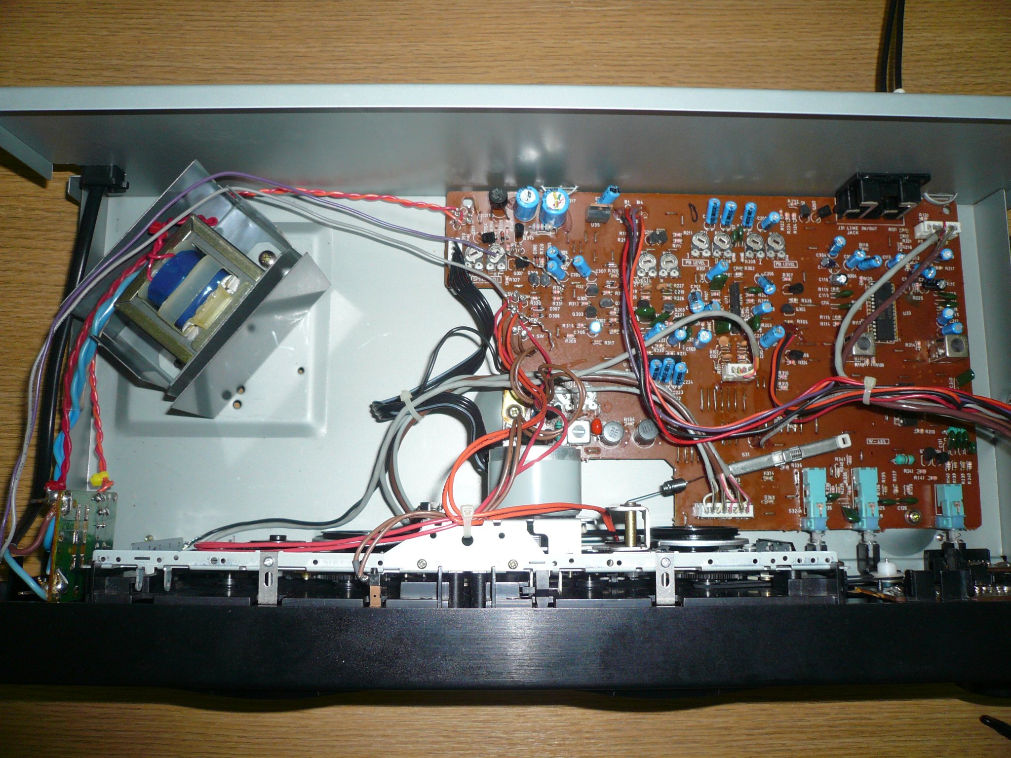

These days I'm playing with an old cassette player, a TEAC W-485C. It's a lowish end model but currently the victim of my diy fever. 🙂 Although it has a regulated psu there is an annoying 50Hz noise. Moreover, this noise gets louder through the speakers when the deck is turned off. Sniffing around I found two wires coming from the PCB to the power switch and connect some kind of load when the switch is off. The user's manual says "The equipment draws nominal nonoperative power from the AC outlet with its power switch in the off position". Does anyone know what is this?

Thanks for reply! It is a ground loop, no doubt. I don't have a switched outlet but the noise goes away when I pull the plug. I forgot to say it's a class II appliance.

Many of low power audio gear had the power switch at the secondary of the power transformer, leaving the primary always connected to the mains. In OFF position, it draws from the mains the magnetising current of the transformer.
If there is hum, try to reverse the mains plug to see if the noise weakens.
If there is buzz, you have to start investigating for ground loop problem.
You may also check the ceramic capacitor from one of the RCA barrels to chassis.

It makes sense. The problem is that in this case is badly implemented. Two 30cm long wires going from the PCB ground to the switch. I cut them and -together with twisting all AC wires- hum is gone. Anyway they were out of the circuit when power on. So, is it mandatory at power off?
Here is a picture. The area of interest is to the left. The power switch cuts the secondary. All AC wires were twisted by me, previously were loose like the purple and grey wires that I cut. I placed them like they were before. The purple takes the PCB ground to the switch and the grey returns it when the switch is off to some kind of load. Like if it had a stand by function but there is no such thing in this. I'll need to lift the PCB to trace that.
