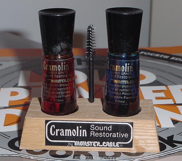

Hi Bobby, Jack,
Here’s what we had in the early 80’s. The stuff is called Cramolin. It was marketed by monster cable and then went to Craig Industries. It appears to be a German company as can be seen by its home page; yeah, the stuff is still around. I think in spray form.
http://www.cramolin.de/
Rumor has it that Craig was sited by the USEPA for the propellant they were using in the spray cans and blamed it on the anti-oxidant ingredients. This allowed them to change the formula and market it under the same name (reported to be less effective and probably cheaper).
I did use the stuff on my connectors, but it difficult to get at the Alps type sealed pots. It will go through my connectors again once I figure I have the system where I want it, and I know it will stay that way for a while.
Here’s a photo of the stuff.
Rodd Yamas***a
