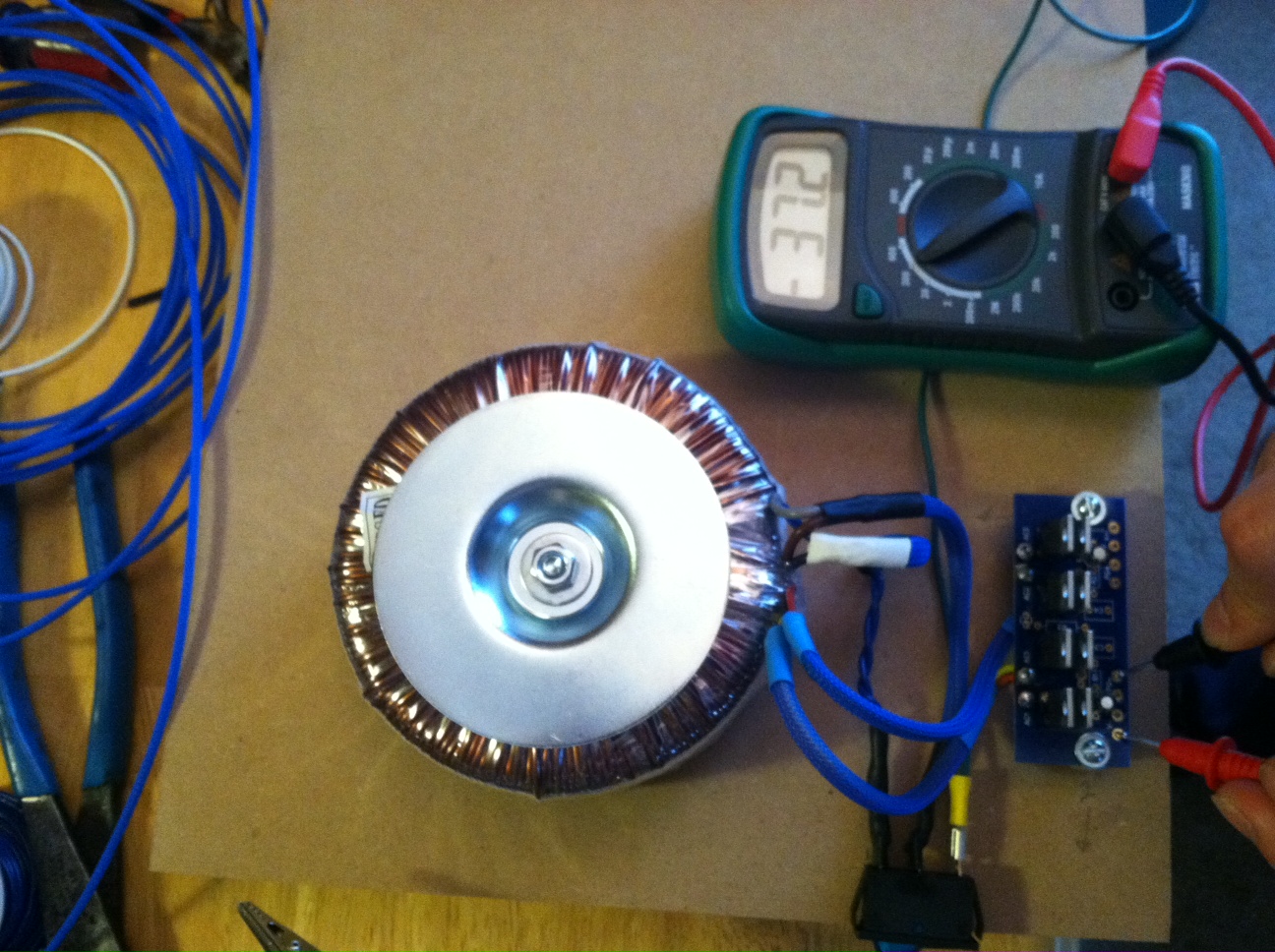

Hi. -I have a pair of LM3875 kits that have been running well for several months.
My transformers (Avel Lindberg 330VA 25v + 25v) have been making noise. This noise does not audible through the speakers. I can actually feel the transformers vibrating when they make noise. A few months ago, it happened once in the evening, and I turned it off and went to bed. In the morning I was going to check into the problem, but there was no noise... in the morning the problem was gone.
This problem happened a couple times over a couple of months, and then began to happen more often. The transformers would always make their noise at night, regardless if the amps had been running all day, or had been off all day and then turned on at night. I thought that maybe the Electric Company here was giving me "cheaper" electricity at night maybe?? -However now the problem happens during daytime hours too.
My suspicion was that I had a loose winding, or somehow something had come de-laminated, and so overtime this loose winding that was vibrating began to get looser and looser and the problem happening more often. Would this be covered by Warranty from Avel Lindberg?
Just a moment ago (and it's night time now) I disconnected the power cord, and plugged it into my test cord, which has a light bulb in-series on the live mains. -When I turned the amp on, the light flashed and immediately went dark. Power is on, light bulb is not illuminated and THERE IS NO NOISE coming from the transformer anymore.
What does this mean? The light bulb couldn’t possibly be blocking DC current could it?
Is there a way that I can measure the AC Mains to see if there is DC there before I go to the trouble of building a DC Blocker or Filter? I'm unsure if the meter I have is up to the job of measuring the mains. I think it can handle up to 10A/250V but in that mode I think it will only tell me that I have 125volts of AC power.
Would you try to return the transformers under warranty, or build a DC Blocker? Is there a way to test for DC on the mains without building a filter?
Thanks in advance for any guidance or suggestions you can offer.

I don't have a definite answer to your problem. Are the transformer mounts secure? Have you checked the AC mains voltage during these different times? The voltage may be peaking at night, or certain times during the day. One thing I'm sure of is that you do not have DC coming in on your AC mains.

As far as how they are mounted, not pretty (old pic attached)… I never did get them off of the test rig, and into a proper chassis. After the first time I heard them make noise, I worried that I may have over tightened them. Since then they have been finger tight, rather than wrench tight. I have the big foam washers on top and bottom. Should I tighten them up more,… or am I right that they don’t need to be too tight?
Another interesting detail is that they both do it at the same time. Unless I plug one of them into the light tester, as I just learned a little while ago. Maybe I should build another light tester.... this just doesn't seem like "the right way" to fix the problem though.
Any other thoughts anyone?

the bulb tester is intended as a protection device and when used in a "working" amplifier will have effects that can interfere with good performance.
The filament resistance when in line will have an effect on the total current passing through the primary of your toroid.
Now to a bit of guessing:
If the hum is due to excessive primary current (flux too high for the core type) then adding the bulb may just reduce it enough to make the hum inaudible.
If that last guess is correct then your transformer is not rated for the voltage you have at home. How do you prove that?
I would test the transformer, but I have some resources at hand and I know my range of mains voltage.
You are on a loser. You have few resources and you don't know your range of mains voltage.

Mine is making a mechanical buzz, but it's been in operation for years and the buzz is only there when there is no load. Of course the transformer has been in an enclosure for the past few years so I have no idea if it still buzzes.
I'd say you 'd need a 12W-25W resistor across the secondaries, at about 25-50R, but these are not cheap. In my case , I remember, the buzzing stops immediately with load, so it is not needed to stress-test the dummy load either, you can simply use a 1W or 5W resistor and as long as it's a small amount of time it should be OK. As a simple guide, with 25V secondaries, a 25R resistor would draw 1A of RMS current.

Here's what I know. At the moment it is daylight. The transformers are not buzzing, and I have measured the mains voltage at 120.5 Volts.
I will measure again at a later time in the day. I suspect that at night, when less of my neighbors are using electricity it will go up to 125V -Does that sound logical? I will report back after I measure the mains voltage when the trafo's are buzzing.
I have the primaries connected in parallel.
So if it turns out that the AC Voltage goes even higher at night, and this is what causes the buzzing because the transformers are supposed to get 115v -then what would be a solution? Is there something simple I can put in front of the transformer that will bring the AC Voltage down to 115?
Another idea I have is that if this problem isn't too big of a deal (i.e. not dangerous, and not affecting performance of amp) than maybe I need to simply build a proper chassis that would hopefully dampen the sound of the occasional vibration so as I wouldn't notice it.
Thanks again for your help!.

Okay, so it's evening now, and the transformers are buzzing.
Mains voltage now measures at 118 volts.
I was expecting the voltage to go up at night, now down. 🙁
Utility is using voltage regulators on the line, most likely. If voltage gets just a little high, say 124V, when load drops at night, the response will be to make a tap change and lower voltage, hence why it probably dropped to 118.
To improve your situation, if the load on the transformer is really constant, you could cheat and install a resistor in series with the primary. But the best way to drop voltage would be to install a small bucking transformer. There are a few threads around that describe how to do this. My suggestion would be to use a split bobbin and connect the secondary into the neutral end of the line voltage.

I appreciate everyone's efforts. Last night during buzzing time, I found that the mains voltage (after dropping to 118v) had returned to 120.5, which produced no buzz during the day time.
I presume that Art M's suggestion would lead me to find possible 'noise' in the mains current, and also to verify if I am getting 60Hz?? However I don't believe that I have the means to safely reduce the power to a level that I could feed it into my sound card.
Interestingly enough, to my untrained ear, when it happens it sounds a little slower than 60Hz. I have a little app on my phone that will generate tones, and a 60Hz square wave is a little bit higher pitched than the sound that my transformers make when they buzz at night time hours. Maybe the AC Mains drops to 50-55Hz at night?
My theory is that the end of the winding has come delaminated a little bit, and that this is a manufacturer error. Really I need to get the whole thing off of the silly piece of wood and into a proper chassis. I’ll call Avel’s phone number about the warranty while I’m in that process. Wouldn’t it be nice if I could just exchange them? They didn’t buzz at night when they were new 6 months ago.
Thanks again for the help!!
Sincerely,
Alex QS
I am beginning to think that DC on the mains has become the intermittent problem.
This too leads to core saturation and the symptom is hum.
Try assembling a DC blocker. (very different from the filter cap on an amplifier)
But DO REMEMBER, the DC blocker is in the primary feed and is at MAINS VOLTAGE !!!!
