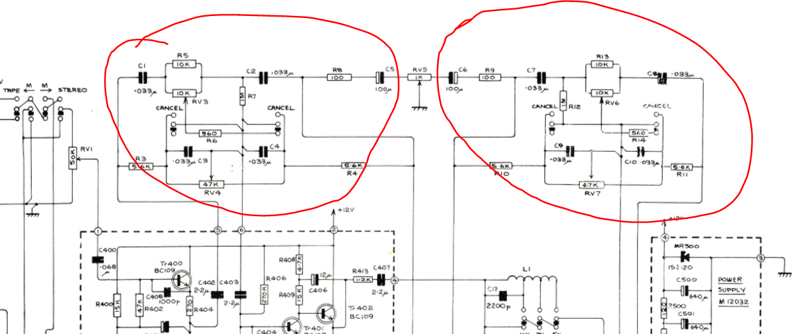

This was the manual I was working to. The tone networks for each channel are shown ringed.

I don't think I have.
I have swapped around the two internal Amplifier PCBs and the fault has stayed on the same channel. This would suggest to me that the problem in not associated with either amplifier board.
If I am wrong, please explain.
Is this a motherboard and lots of daughter boards that slot in vertically?
If the channel remains in the same physical location after swapping daughter boards, then that points to the mother board and what supplies it, or comes out of it.
