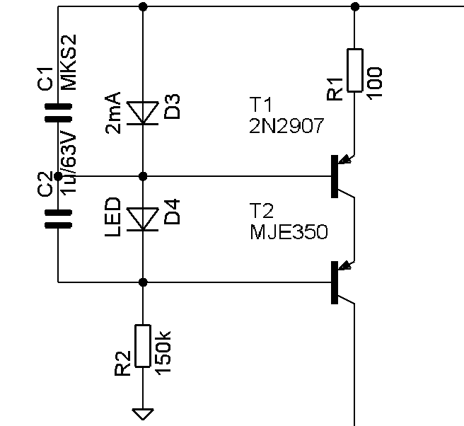

I have called attention for the fact (post# 16 ) , that probably the noise came from the CCS...but nobody care...🙄
dsavitsk..what is the voltage between the anode of the tube and the + rail?...I suspect that the transistors are in saturation state , therefore having a very low impedance between the tube anode and power rail..

I care, but the design is used in a lot of places, and I've not heard of anyone having stability problems with it.
About 35V, which is well within limits of the circuit. All things considered, I am running this pretty conservatively.
I agree with Tube dude. It takes 5 minutes.

Some updates:
I increased the bias on the led's to 4mA (Doc at Bottlehead actually suggests biasing to 10% of the current over 10mA whilePJ says 20% I may increase closer to 8mA at some point to see what happens.) I also put a 1uF film cap across each one of the led's. I tried some of the noisy tubes, and they were still noisy. They may have been a little less noisy, but not hugely.

Bypassing an LED with 1uF won't do much. An ideal (for this purpose) red LED has a slope resistance of about 5R, and even a less than ideal red LED is likely to be less than 20R. 1uF will only begin to affect 20R at 8kHz, and would only affect the best red LED at 32kHz.
