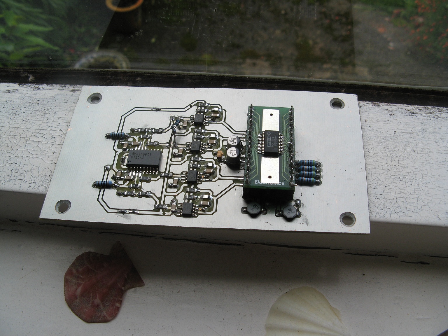

It's built on a double sided PCB with the underside acting as a ground plane, all with surface mount parts, except the ADC chip itself which is on an SSOP>DIL adaptor - I know, not perfect, but I need to be able to remove the chip easily.

I've compared the PCB I've designed with the evaluation board from TI and they are very similar. The only major difference is that my 4202 is on a SSOP to DIL adaptor and the Texas board has it soldered directly.
The SSOP adaptor has a 'ground plane' or rather a layer of metal beneath the chip and does allow you to solder some decoupling parts directly to the pins. As a result I tried soldering decoupling caps directly onto both voltage references and the digital power pin, this didn't really improve anything.
Is this the kind of thing that will improve decently if the chip is soldered directly to the PCB instead of the adaptor? I would prefer to keep using the adaptor if possible.

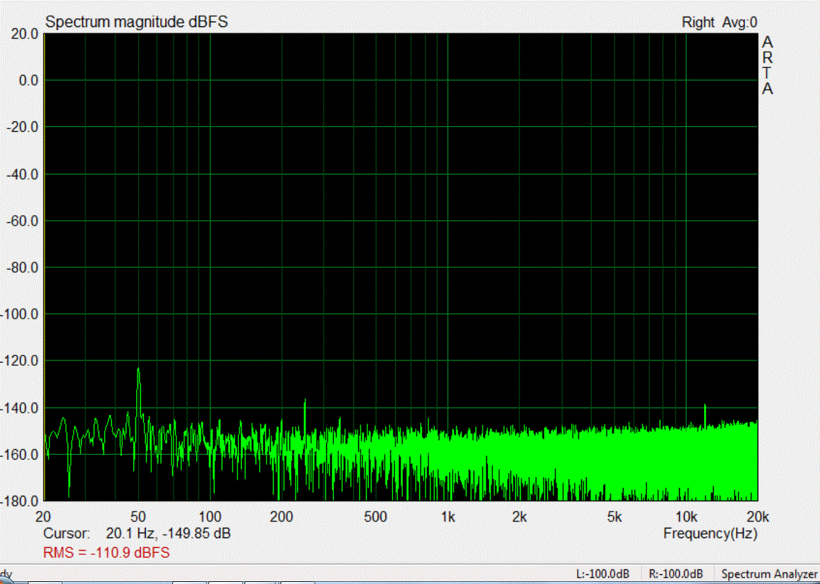

The first picture is just the ADC running with no input.

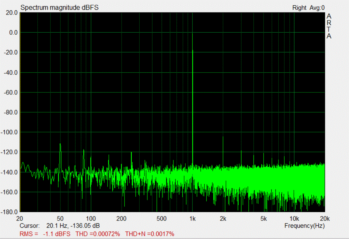

The second is the DAC feeding my Preamp/Active crossover, where the signal is buffered and sent through a TPA6120 headphone amp. I then take the signal out of the headphone socket and back into the ADC. The noise floor rises somewhat as a result of this, but is still low enough.
Interestingly enough I did manage to get a reading with 0.00032% distortion at 48khz, but I didn't screen shot that. I find that pretty amazing considering that's better then the spec for the PCM1794.

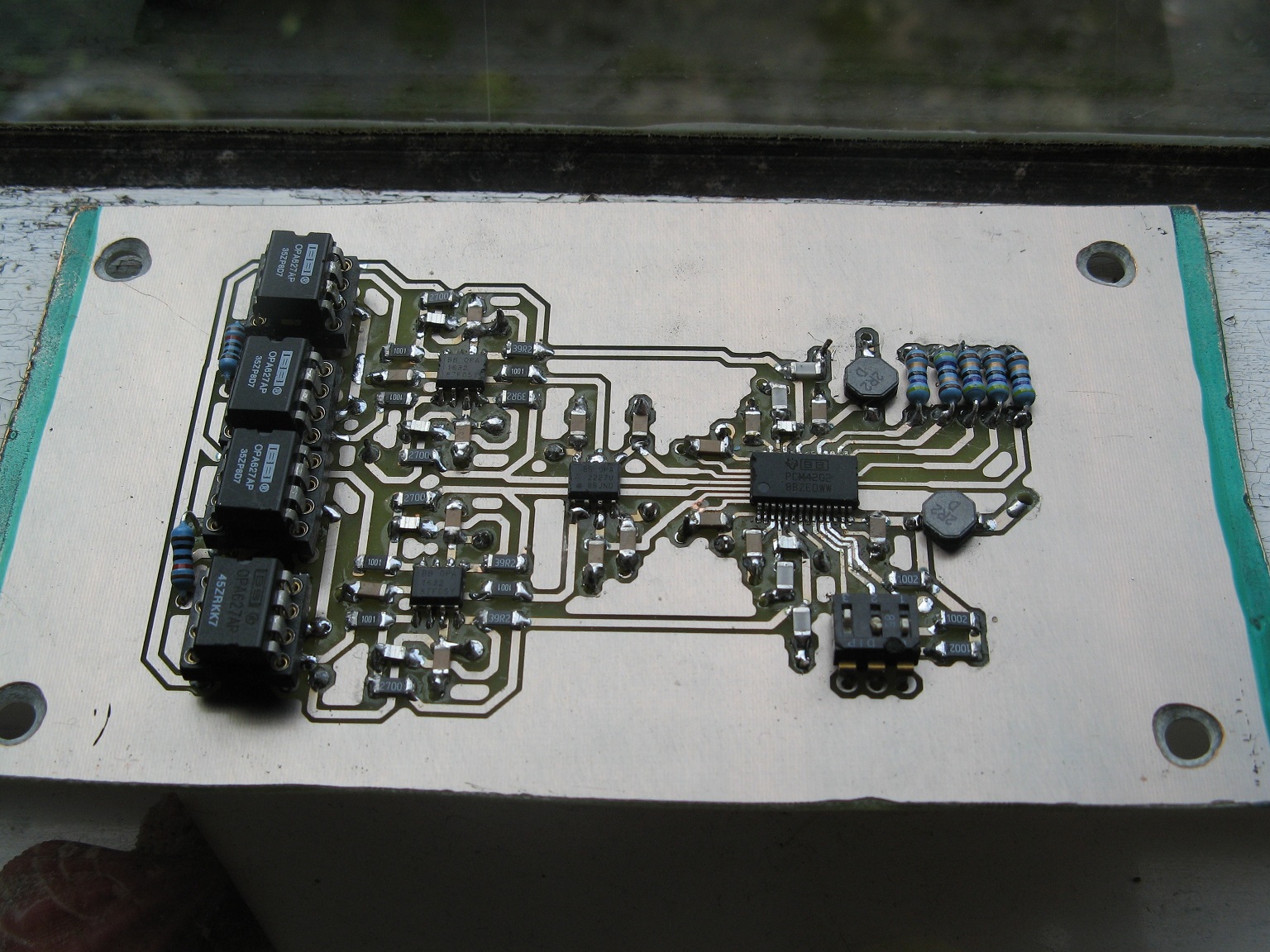

The first picture is of the ADC board itself. It seems that removing the SSOP>DIL adaptor really did help the performance significantly.

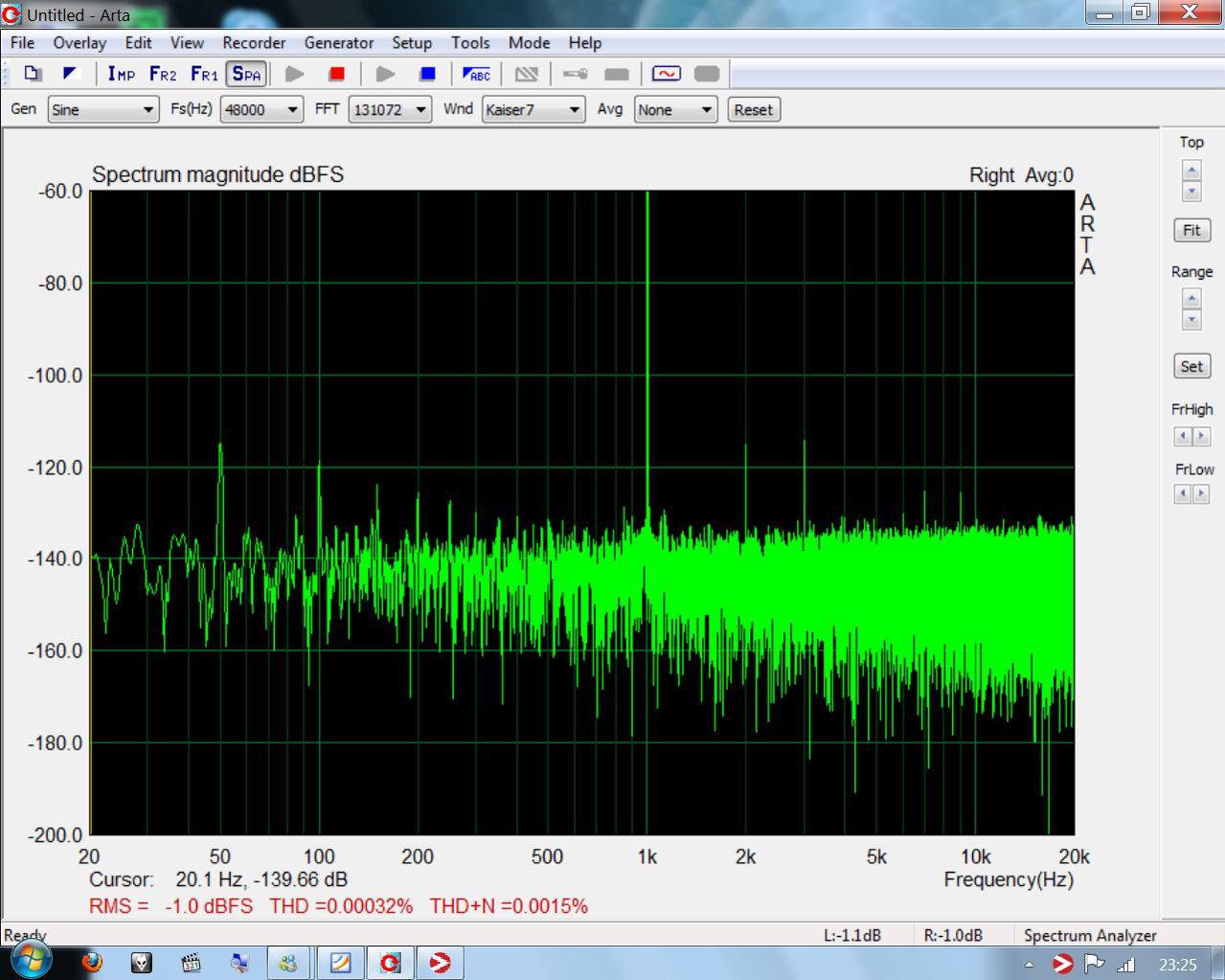

The final picture here represents the best performance I've had for distortion out of this. The figure of 0.00032% is quite amazing in my opinion as it shows TI really do show numbers your typically able to achieve with their chips. The noise of the ADC is lower then this when the Pre isn't connected to it. From a picture above you can see that the noise floor = -111dB and I think TI quote -105dB for noise + distortion, which I'd get if the Pre amp wasn't 'so' noisy.
