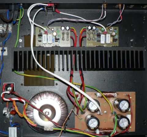

So...the mains safety earth...Right now, it's connected to the heat sink which is bolted to the chassis (=real good electrical conductivity with the chassis). Do you think I need to actually move the safety earth so that it is physically connected to the chassis? Personally I think there is enough conductivity with the chassis, but I appreciate opinions.
As for insulating the chip--am I good there? The way the edits look, I'm a bit confused. The amp functions beautifully save for the noise when no signal is attached (I haven't noticed any "destruction noises" while listening to it). 😉

Yes, you must move the safety earth to the chassis. And make it permanent.
Following on from BWRX on LIVE wires strewn about the insides. If you insist on running mains wires around like that then run double insulated two core for the flow and return and insulate the ends from interfering fingers/tools. It might not be you that opens it up one day!!!
I just checked my order, and unless they sent me the wrong part, I have the TF--so I guess I'm good on that. I'll double check when I get home, though. I'm not sure I like the idea of destruction. I'll move that safety earth--I suppose I don't want to get electrocuted...and the strewn about live wires: I'll thake care of that too.
Now that we're safe, any ideas about noise?

Make sure the signal ground only goes to the amp PCB. You can separate the signal ground from the power ground by adding a 10R resistor in between.
If you haven't tried a ground wire from the star ground to the chassis earth, give it a go. You can also add a 10R 2W resistor that has 2 opposing diodes in parallel to the end of this wire like in the pic.

The signal ground is to the PCB only, and through a 10 ohm resistor. I re-grounded the input shields and moved the live mains. I got cold feet about connecting the star point to earth. Could this really be causing my noise? I don't really want to do that unless it would solve my noise problem. I'm somewhat concerned about moving more current around on wires that go right next to the PCB where all the senstive stuff is. From what I understand, the way things are now there should be little or no current on the earth connection unless something goes wrong, and I'd kinda like to keep it that way. Is there a chance that making this connection would cause current on the earth conductor (substantially larger than the minimal current from the shields, and more frequent than current caused by some accident)? It seems like the smoothing capacitors would take care of any problems with noise at the star point. Anyhow, keep the advice coming, I really appreciate it!

Everything except the chassis ground (green wire/earth, to heatsink, white wire to chassis) is grounded to that fat fat wire running between the capacitors. At some point (you can see if you look close) the fat fat wire is attachedto the center tap of the toroids. Does this count as "star ground?" Might the noise go away if I run the earth connection (green from mains) to the star point(fat fat wire)? Does it look like my wiring is separated well enough? The signal ins gets kinda close to the output wires, but those are shielded (more on that below). I don't have any pot in that amplifier (full power all the time!! YEAH!). I figure volume can be managed by the input device until I get my preamp built (project #2 for the summer).
If you (in response to no one in particular) look real close, you can see the signal input jumping up over everything there. Those are the (other) white wires. Those are shielded, and I had them (shields) grounded to that earth connection on the chassis. The noise persisted. I disconnected the shield from there and the noise didn't change at all (that I could tell). An interesting note: the signal ground goes to the PCB, and then to the fat fat wire (star ground?) through a short (really short) trace and resistor. Would this cause a problem? My friend designed the board, so I'm a bit wary to modify anything there--I have confidence that he knew what he was doing when he designed it. Would there be an advantage to connecting the fat fat wire (my star point?) to the mains earth? How about connecting the signal ground to mains earth?

I don't quite see how your grounding is done. (A schematic would sure be nice...)
For a star ground, you'd probably want to take all grounds, *separately*, to the negative side of the main filter capacitor(s), or somewhere just off center, between them. --> i.e. If they all run together, in some length of wire, then you have ruined the star grounding. The center tap might be OK, if it were VERY close to the caps. But ideally you don't want the currents to share any length of wire.
The inputs' shields' grounds running to PCB signal ground through a small resistor (like 4.7 Ohms) is a good thing. BUT, you DON'T want the input jacks' grounds ("outer barrels" of the connectors) to be connected to the case. So you'd have to have the insulated type of jacks, or else mount them on a non-conducting material in a cutout.
Where do your speaker grounds go? Do they run separately (i.e. by themselves) all the way to the center tap (or, preferably, the gnd side of the caps)? Note that they should be insulated from the case, too, just like the inputs.
Your mains wiring could be causing hum, too. Remember that wires with changing currents will act like transmitting antennas, and can capacitively couple to other circuitry.
Anyway, I don't remember you saying anything about what happens when you short the inputs to ground. Is there hum, then?
I'd use an ohmeter and measure from your center tap or caps' gnd to the case, first, and verify that there's no connection, anywhere. Then, if you want to try connecting the center tap to the case through a 10 Ohm resistor, you can do that and see if it helps. If it does, you'll want to use a full "disconnect network", instead of just the resistor, which is usually two antiparallel diodes and a 0.1uF cap, all in parallel with the 10R.
