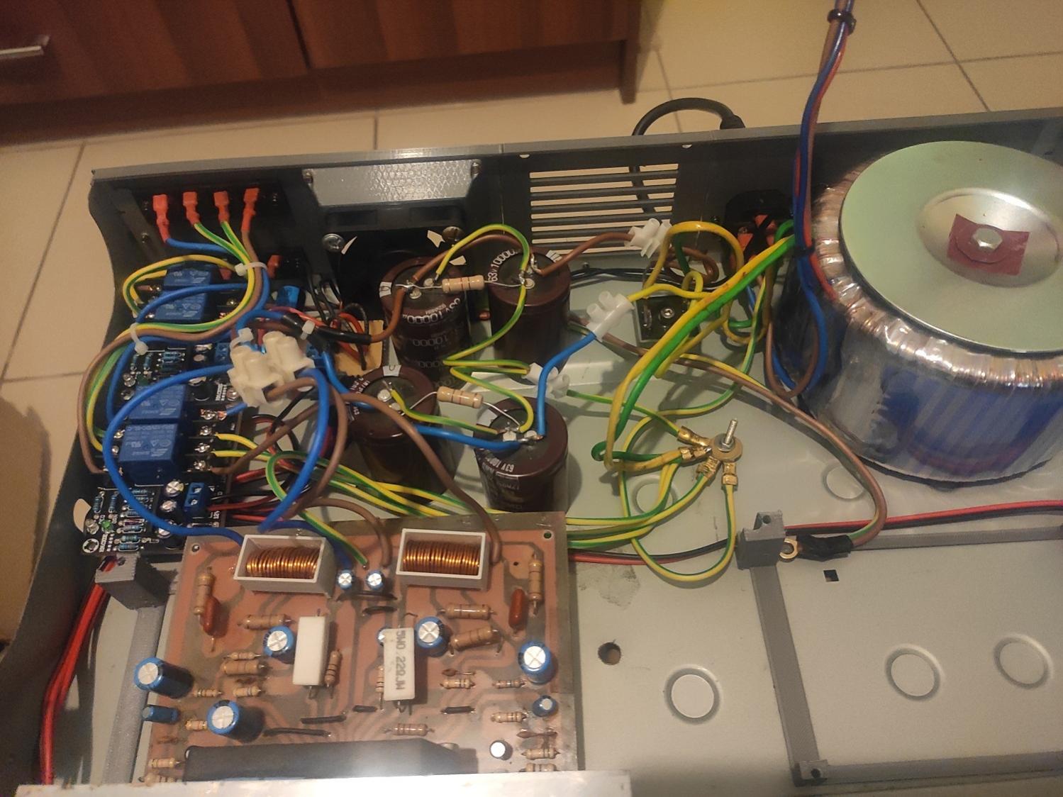

10 years ago I made a amp with two STKs 4241 II.
A few months ago I decided to rebuild it ,since the first build was hasty and had some noise.
I finished it a couple of days ago and it works fine except some issues.
First one is that there is too much treble.I connected a pre amp I made with a NE5532 and I have to cut down 20-25% of treble to make it sound good.That happens either with the preamp(without cutting down treble) or with a signal straight to the amp.
I guess it has something to do with the input capacitor.Everything on the board is what is stated on the datasheet so the capacitor is a 2.2uf.
Second problem is a bit of a hum when nothing is connected but that's not too annoying,as it's not too loud.It could be a ground loop and I will check my grounding again.Note that I star grounded everything.
Third issue is that when input is connected then more noise appears,at different frequency, that increases when I increase the volume.The volume is adjusted by a pot connected to the RCA.Could that be RF interference?Note that the front and rear of the chassis are plastic as they are 3D printed.Chassis is grounded.
I will upload later some photos from the amp and a drawing of how everything is grounded.
I have a toroidal 600VA transformer ,two STKs on 2 different boards,the input signal cable is shielded,however some 220V cables are nearby so that could be the reason for my second problem.
Thanks!

I started doing some tests and removed everything from the input of the STKs.
When I connect something at the input then noise appears.Even a single extension cable does it.
The noise is at high frequency and I think that whan triggers that is also responsible for my problem with the treble,as it is a bit distorter at low volume and there is too much treble at higher volume.
The STK module 4241-II is rated 120 watts per channel at +/- 53 volts at 8 ohms.
So +/- 50 is close to the limit.
Put a bigger rated speaker, heat sink it properly - most dangerous if they overheat, they act odd, and sometimes they take the speakers and transformer with them.
Your issue sounds like a noisy input, stray noise somehow, and too much gain.
Put a 63 or 100 volt rated 2.2 uF cap in input, and try to put a 47 or 100 ohm to ground in series or parallel to it, see what happens.
Also try a 0.1 uF in parallel as a treble filter.
But do the heat sink part first, use a thin film of heat sink compound. Fasten it properly to the heat sink.
Sometimes permanent damage happens if overheated, they work, but not well, and fail early.

So,I did some tests.
Removed the input wires at all.
Replaced the coils with the proper ones.
When no input is connected,noise is actually pretty low.
However there is some DC offset.
I measured just one STK and on one channel it's 130mV DC and on the other channel it's 150mV.
Could this be the reason?
Also when I connect a wire on the input noise appears and I have 80-100mV AC out.
The noise is always coming from the tweeter so I guess I have some high frequency oscillation?

What I've build is thisDoes the amp have an RF filter on front end ?
STK4241 STK4201 STK4221 STK4211 STK4231 Amplifier Circuit - Electronics Projects Circuits
So I guess there is no RF filter.
Is there any simple circuit so I can add one?
Same speaker on a Marantz amp plays just fine.No distortion and treble is just fine.100-150 mV DC off load is barely okay
Check on load.
Also see if tweeter connected properly through good quality cross over, sometimes it is just a cheap capacitor!
I tried a couple of things at that Marantz amp and figured that noise appears there too when input is connected.Less than the STK but I guess that's because the STK has more gain.
So I guess the noise with the input thing,is normal and I should focus on finding out why there is too much treble and also why treble sounds a bit distored on low volumes.
