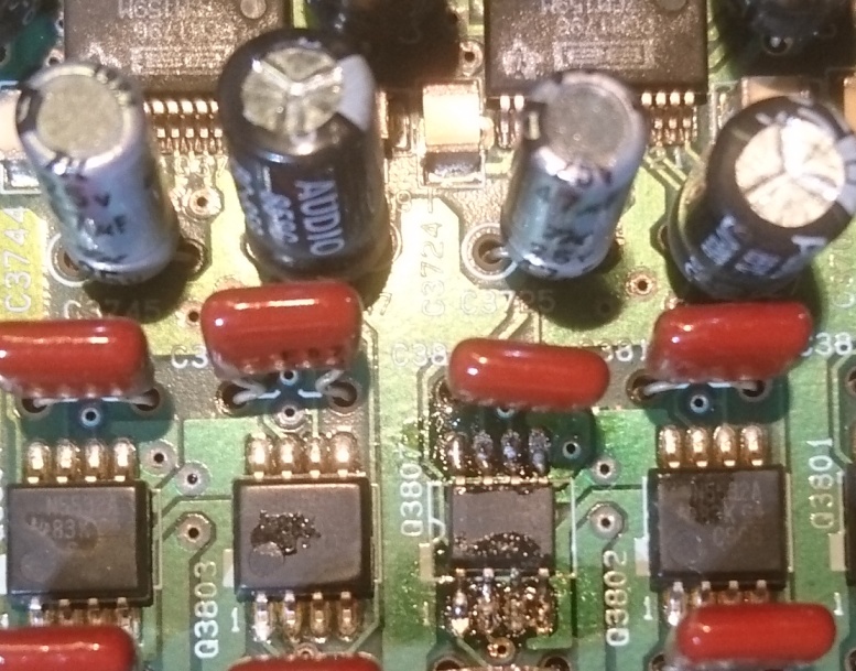

I tried replacing the integrator capacitor - Did not change anything
Replace the NE5532 OpAmp in the integrator - BINGO?

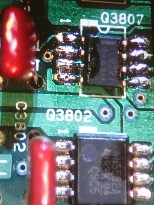

I replaced with a TL072, which is a bit smaller package as the image shows
I have not seen the noise after changing the OpAmp.
I will still put back a NE5532 when possible (and hope the issue do not re-appear)

This week i also got the correct replacement opamp - NE5532A in the SO8
housing (a bit wide than SOIC8)

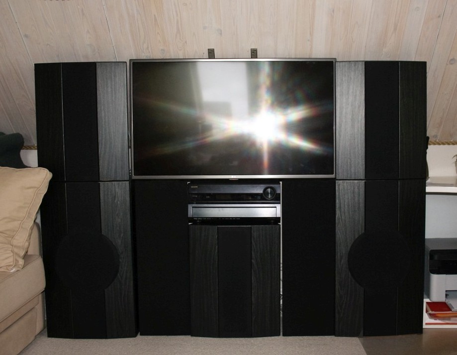

Exactly, it for the old Jamo System One (at my parents)Congrats. So you can now use passive subs with your reciever? This way you can use the recievers high and low-pass?
I put the receiver back to my parents again.
The room correction worked just fine with the amplified-Subwoofer modification.
I also tested with a single WW2-movie and the subwoofer gave just the right supplement. I did not think about the subwoofers as being underpowered as tanks where rumbling through.
