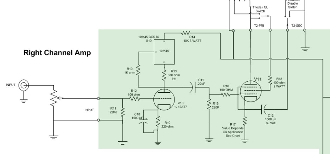

I built 2 Tube Lab SSE amps last year and have been very pleased with both of them. I built a SSE 6L6 and then another SSE, KT88. Both of them operate perfectly and sound amazing except when I use a potentiometer inline with ether amp. At first I assumed the pot I was using was at fault but came to find out that it may be something related to the amp.
The symptoms are as follows. Regardless of whether or not anything is plugged in the amp sounds really clean. But when turning the pot down anywhere below max, an intermittent, crackling, static (sometimes squealing) sound starts to come from only one of the speakers. This follows when switching speakers and appears to be affecting both of my amps. I thought it was a bad pot and replaced the one in my KT88 amp, but it only made things worse. I tried a solid state amp (Gainclone) and have no issues at all (except it isnt a class A tube amp)... Originally I discovered this issue when making a little source switcher with a pot installed but it turns out this occurs in the amp directly. Please see the post below that I originally put online which led me to this discovery. A lot of people suggested RF filtering, but I want to be sure there isn't anything wrong with my amps. If requested I can post a recording of the noise.

It's oscillating.

I would say the big difference between an amplifier and an oscillator is positive feedback, so you likely have a positive feedback loop around that side of the 12AT7, which is a pretty high gain device, and often used as an oscillator.
I don't think the SSE is prone to oscillate, so you probably just have an unlucky combination of all the component tolerances going in the wrong direction, and then causing this. Replacing the 12AT7 would probably fix it. You might have to increase the value of the resistance in series with the grid.

Thanks! I actually added the pot(s) after finishing the amp(s) hence the lack of pictures. I figured I would just use a preamp, but decided to save my speakers and wire in the pot after all. I used a 100k ohm wired up just as specified in George's diagram. I did use 100k instead of 50k as George suggests, and made some adjustments to the filter and coupling cap values according to an amp designer friend of mine. I'm starting to second guess those decisions now.
How much do you suggest I increase it? Currently it is 100ohm and when I turn down the pot isnt that adding to the value? That is when the noise starts. I am still pretty new to all this so please excuse all the questions?
I'm guessing the feedback path is up R11 and through R12 into the grid, so the series resistance of the pot is irrelevant to that path.
The parallel part of it may be having some interaction with R11, however.
You may have several things going on. Hiss can be oscillation or a bad tube socket. Snaps and crackles can be a bad tube or socket. Squeal is always oscillation in my experience.
I would change the 12AT7 before I did anything else.

I swapped out the Telefunken ECC81 (12AT7) and the problem cleared up tremendously. I can still hear a faint static sound when the pot is at about 12:00 but its about 10 times quieter than with the Telefunken tube. Hmmm I wonder if I got some bad tubes off E-B@Y? Anyways, that definitely helped. Im using the same tubes in both of my amps so that might explain it.
Okay so it seems to be a bad tube. Actually 2 bad tubes. Both are NOS telefunken ECC81 that appear to be genuine. At least they have the molded glass stamp on the bottom. I don't think they are fake but I frequently hear about this problem with Chinese made tubes. What else is weird is that the tubes went bad in both amps. With the same symptoms. I'm wondering now if I did something to fry the tubes maybe? This whole thing started with a passive preamp I made with an A/B switcher + potentiometer + 10db pad. Any chance something like that could have killed the tubes, or was it just bad luck?
