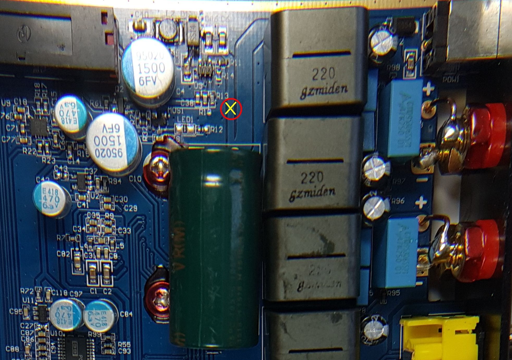

I have an Alientek D8 amplifier. The only problem with the device is continuous noise / hiss, one user used a 15uH inductor between + Vin DC Socket and + Vin 5V DC-DC regulator, apparently it reduced noise almost completely. The question is, isn't it better to use, for example, 200uH or 1mH inductor that will remove more high frequencies?

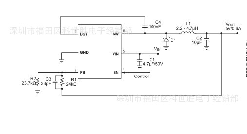

In your Google Drive pictures it looks like the device marked SS14 is the catch diode and C36 is the boost diode. The device marked 4R7 is the buck output inductor. You can see that what would be pin six in the picture from audeo is connected to these components where the solder mask is missing. That would mean your left arrow on the Google Drive picture is pointing towards pin 5 which is almost where you want to insert the inductor.
As FF suggests in this case smaller is better. Switching, and linear, regulators can be picky about what you hang on their input and output. C46/C4 appear to be the input decoupling capacitors. Hard to tell but could be in parallel. However they look a bit small to be a total of 4u7. Hard to tell with ceramic chip capacitors. That might cause erratic behaviour if/when you add your inductor. I would go for it but would be wary about possible overvoltage due to undamped ringing. Grumble.
It looks like your target track to cut and place your inductor is the one under 14 of R14. It's not going to hurt if you tag a small electrolytic, 10u-47u across C46/4 and that might tame any possible ringing.

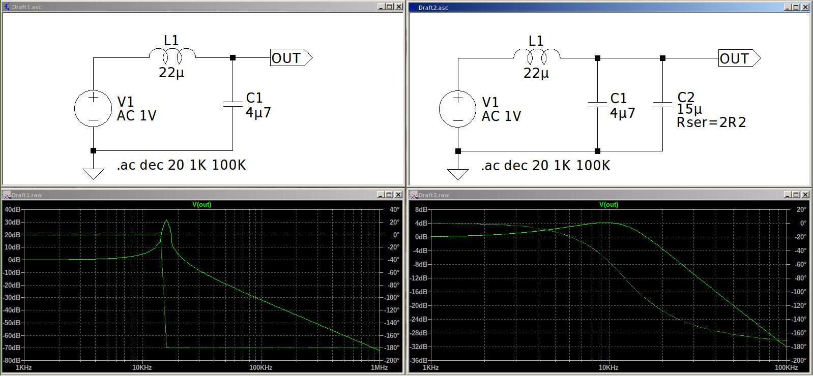

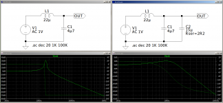

Just to add, if it makes sense, you are creating an LC filter and ideally it should include some form of resistive loss otherwise it will be underdamped and ring. 4A/22u will not have much winding resistance and core losses are probably low. Then you have ceramic capacitors which will have a low ESR, equivalent series resistance. The electrolytic will have a higher ESR and help things out. All said and done its really something you need a scope for.
Burble 22uH and 4u7, assuming C46/4 add up to that, has an impedance, root(L/C), of about 2R2 so you should find an electrolytic with something in that range of value of ESR, it's parallel damping.

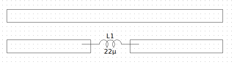

It sounds evil but that's the idea. The inductor needs to be in series with the input supply and the regulator so unless there is some other means of breaking the path you have to cut the track. Scrape off the solder mask. Score it through with a scalpel in two places then use your soldering iron to heat up the middle bit whilst gently scrubbing it until it drops off. Tin the two bared ends and add your inductor.
Sorry, just spotted your edit. It looks like audeo has done what I am suggesting, X marks the spot. I've just added a concern about damping.
i thought that i can solder inductor with longer cables to IV7JK pin 5 and boost/catch diode pin
That does not, Inductor from pin 5 to pin 6, achieve the same result.

MorbidFractal is far ahead of me having an overview of the actual implementation. I studied the photos of the PCB last night but I cannot see how the tracks are running near the small voltage regulator. I could not find a datasheet matching this tiny IC.
You will have to cut the relevant PCB track, for a start in one place, scrape off the protective solder mask and for a start connect a 15-33uH choke with short wires (leave insulating plastic below the choke) to the two points of the PCB track
So you mean that i should put choke on one track, not between two tracks like here?
https://www.diyaudio.com/forums/att...587780-fda-alientek-d8-inductor_placement-jpg
Im very sorry for my ignorance but i dont know how these all works, i just can ask should i solder it here or there and unfortunately audeo no longer uses this forum
I have some small capacitors (electrolytic) so i can use them to be sure

A physically smaller inductor will probably sit on the cut track.
