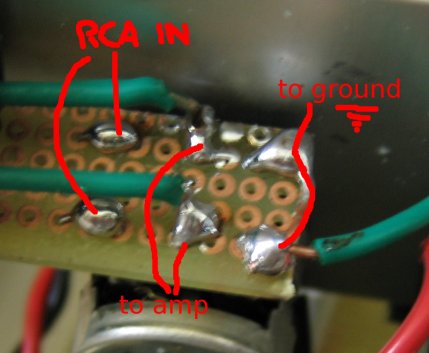

I have finished building a headphone amplifier:
http://headwize.com/projects/showfile.php?file=szeke1_prj.htm
replacing r4 with an lm317 current source, as suggested in the project addendum
now, it has a good sound, but there's noise coming from the volume potentiometer: that is very low or nothing when it is full on or full off, but quite loud when the pot is about half
i tried to wire the case of the pot to ground, but it made it even worse... now I removed it, but it didn't change much
by the way, the noise is present on both channels at equal level
what should I do? i'm really thinking about removing it ...
i wired the first pin to ground, the middle goes to the amplifier circuit, and the last one is from the rca input
it's "reverse" wired, that is you turn the volume up counter-clockwise (but I don't think that's the problem)

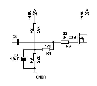

When the wiper is in the middle position the pot represents a source with higher impedance (0.5 times its nominal value) than the stage driving it. So the middle positions of pots are prone to capacitively coupled noise (additionally to the aforementioned oscillation possibilities).
How long are your connections ? Are they properly shielded ? What is the input impedance of the stage "driven" by the pot ?

The problem is most likely that you don't have a very good ground return on the input of the circuit since you're apparently relying on the pot and it's wiring. I'd recommend an input termination resistor be installed in the circuit from R1 to the circuit ground to assure a good solid termination without any leads involved. Something around 50K is a standard value, but it would depend on what value you're using for the pot and what kind of load impedance you were trying for. I'm kind of surprised that was left off the schematic because it's fairly standard practice. You do have C1 in the circuit so that the input impedance doesn't effect the bias, right?

Sorry, didn't notice that there was a link to the schematic. Yes, the FET stage has definitely a very high input impedance (at least at low frequencies) and is therefore prone to stray pickup.

Amp
If the noise is in fact hum then you need to tie the input jacks ground directly to the ground of the pot. The input jacks should be insulated from the case, and all grounds TIED TOGETHER and then to a point on the case. Also as I suggested before take that messy pc board off the pot and wire directly to the terminals of the pot.
When you hear hum when your hand is near the pot it means the ground for the pot is not good.
The termination resistor for the end of R1 is also a good idea. Somethig about 470 K so as not to lose bass response. Check with different values to see.
Hope all this helps
Ed
Hope all this helps
Ed
m0nty said:....now, it has a good sound, but there's noise coming from the volume potentiometer: that is very low or nothing when it is full on or full off, but quite loud when the pot is about half
Your problem is the noisy power supply and
inadequate Fet biasing circuitry, IMO. Use a well-filtered power supply or try a diferent biasing method, as shown in the picture below.
Milan

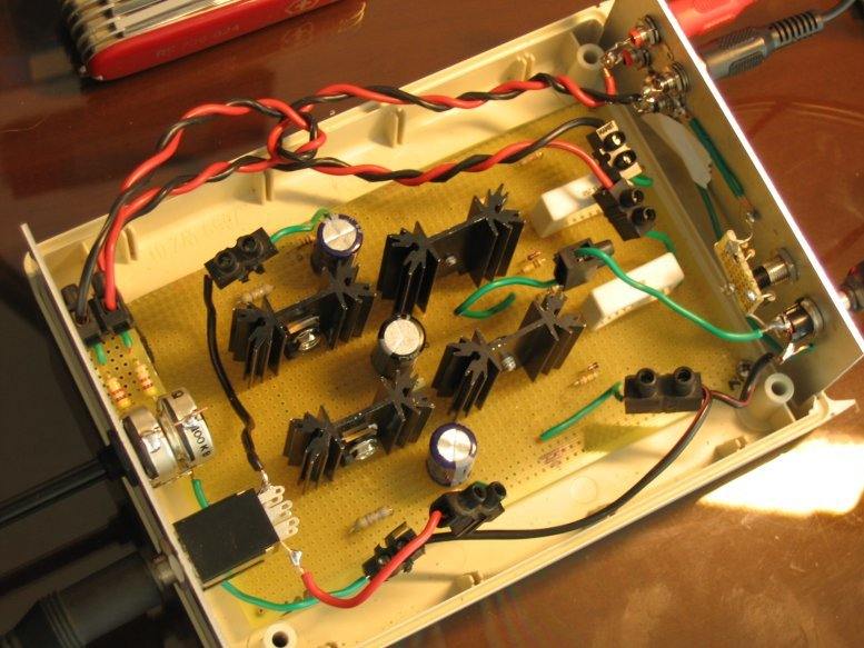

i tried adding the resistor after R1 as suggested, but didn't get any better - now, with the resistor on a channel, and the other without, there is absolutely no difference
about the wiring, here is a photo:
as you can see, the ground is wired to both the metal panels of the case
the rca jacks are not isolated from the case
Amp
You should have shielded wire from the rca jacks to the pc board, and from the pot to the main board. This is a high gain circuit with very low signal voltages, its a wonder the hum isn't overpowering. Make sure both ends of the box are wired together, better yet use an all metal box.
Those screw connectors look pretty bad too. Do you use them so you can remove the amp from the box?
Ed
Ed
