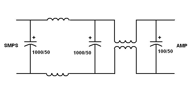

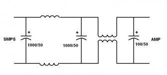

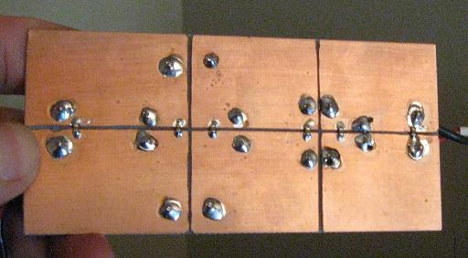

Update on my TPA3116 that I had at the show.
Put it in a box with some other stuff and I have some "noises" similar to what you may have heard with your amp / SMPS combination.
I had a piece of one sided pcb and some very low ESR caps and chokes laying around (inductors from computer PS...output filters, the common mode choke from computer ps)
put some cuts in it and drilled some holes (most in the right place)
Threw in some 0.1uF 0805 caps as well
built a filter and installed it...no more SMPS noise.
