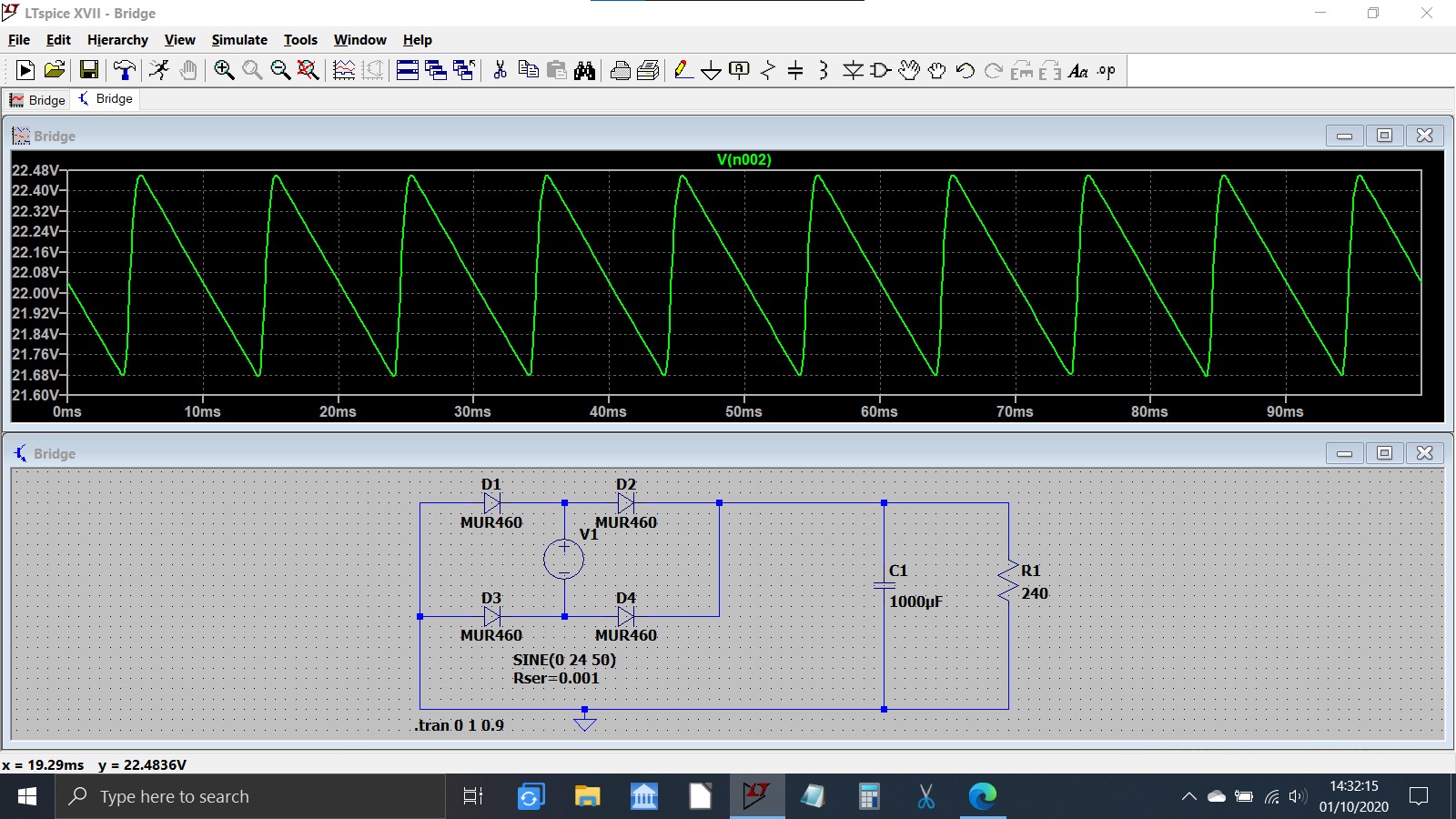

Look at this simulation. The AC voltage is set to a peak of 24 volts which corresponds to a 17 volt rms source. The DC voltage across the cap is shown here.
The load resistor is set at 24 ohms (to draw a nominal 1 amp) and then set to 240 ohms (to draw just 100 milliamps). At 1 amp the troughs in the DC voltage dip below 16.8 volts and this would not operate a 7818 satisfactorily. At just 100ma loading the DC voltage is much higher and this would be fine for a 7818 (Images 1 and 2)
The third image shows the diode current at 100 milliamp load. You can see it conducts for only a short period of time but pulls a lot of current.

And for completeness this is the original configuration you had. The voltage across the 240 ohm load is shown.

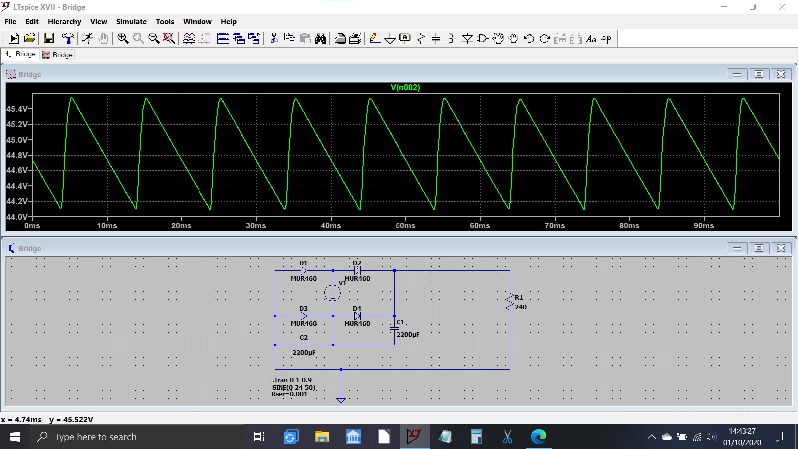

Next we increase the value of the caps to 2200uF. Now things are looking a whole lot better in terms of the voltage holding up.

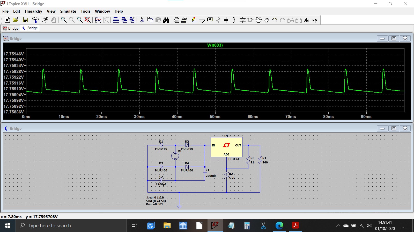

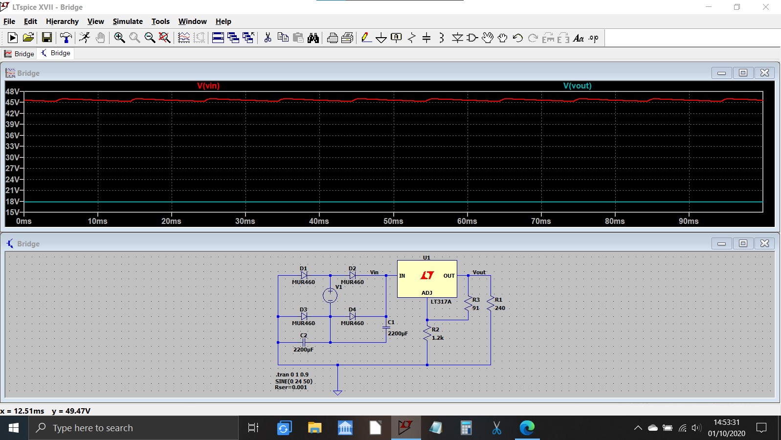

One possibility for your 18 volt supply would be to use an LM317AHV (the high voltage version) three terminal adjustable regulator. Look at the scale for the 18 volt supply.
