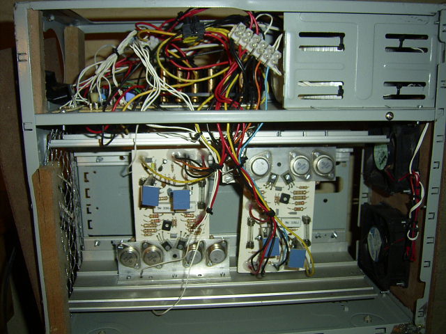

then I try to debug my UPS it sometimes trip then I plug the amp in with the same UPS line, and I hear a noise on my speakers then it runs on battery power (mains failure), because of my modified sine wave inverter, but my mixer and pc doesn’t make any noises
the noise does come from the speakers indeed and a little but from the amp's transformer
Basically my amp is the reason why my inverter keeps on tripping, most of the times, so I assumed it a noise or something that causes my inverter to trip, it give a red light, red light means low batt, high temp and overload, but this only accurse 70% of all times that the thing trips itself.
So can it be that my amp has a high rush in current then I switch it on, but that delay is only ~3 millisecond long, then it takes for my UPS to switch from mains to battery power, so this is extremely weird for me

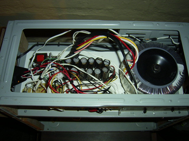

It may be an amplifier start up problem that is causing the delayed trip.
Build in a temporary Power Thermistor to the transformer primary of the amplifier and test for clean start up.
If this helps then design/copy a resistor+relay bypass with 555 timer (about 300ms) for the amplifier.
The other problem may be that the high current charging spikes are upsetting the inverter which wants to deliver modified square waves to the loads, rather than short period spikes. A smaller first stage capacitance followed by a large inductor with higher value second stage capacitance will reduce the current spike.

at start up, a toroid can have zero or reverse flux in it's core relative to the momentary waveform of the supply.
The worst case current spike is Vpk/pri Re. This can approach 250Apk for a 1kVA transformer. That is some inverter, if it allows this without collapsing.
