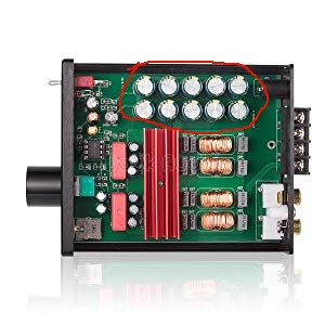

A lot of these mini-amps ship out with 19 volt supplies... and that's for a reason. Usually it signals they've used 25volt capacitors on the bulk supply rails (see the thumbnail). Plugging in a 24 volt supply without checking this first can lead to damaging the caps, even exploding them, if any are even slightly off tolerance.

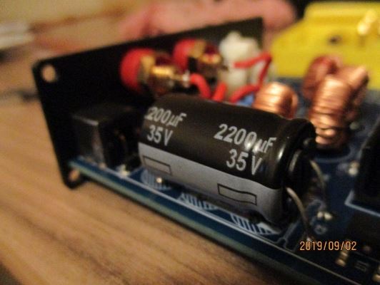

i use 24V PSu and the caps are lickly 35V - 24V are too closed to 2%v of your caps -change the psu to 19V.

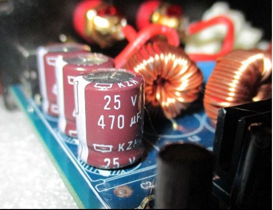

One of my ways of making a little extra cash is to bring in, improve and sell these little mini-amps to friends and friends of friends. I've had several of them come in with 25volt caps that explode only a few minutes into using them. ... like in this video
It's likely they are counterfeit or recovered parts, so I make a habit of replacing them. And you'd probably be quite surprised how many of these things have the provision for it right on the boards...

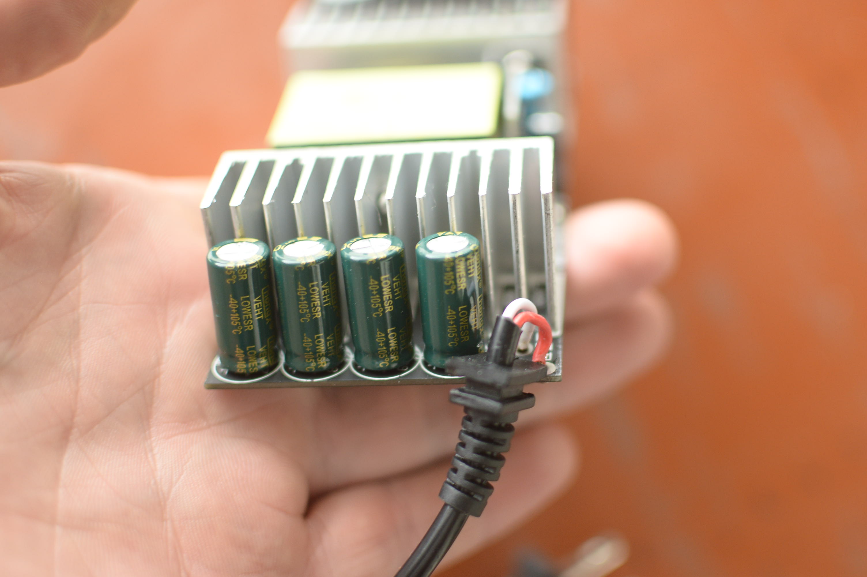

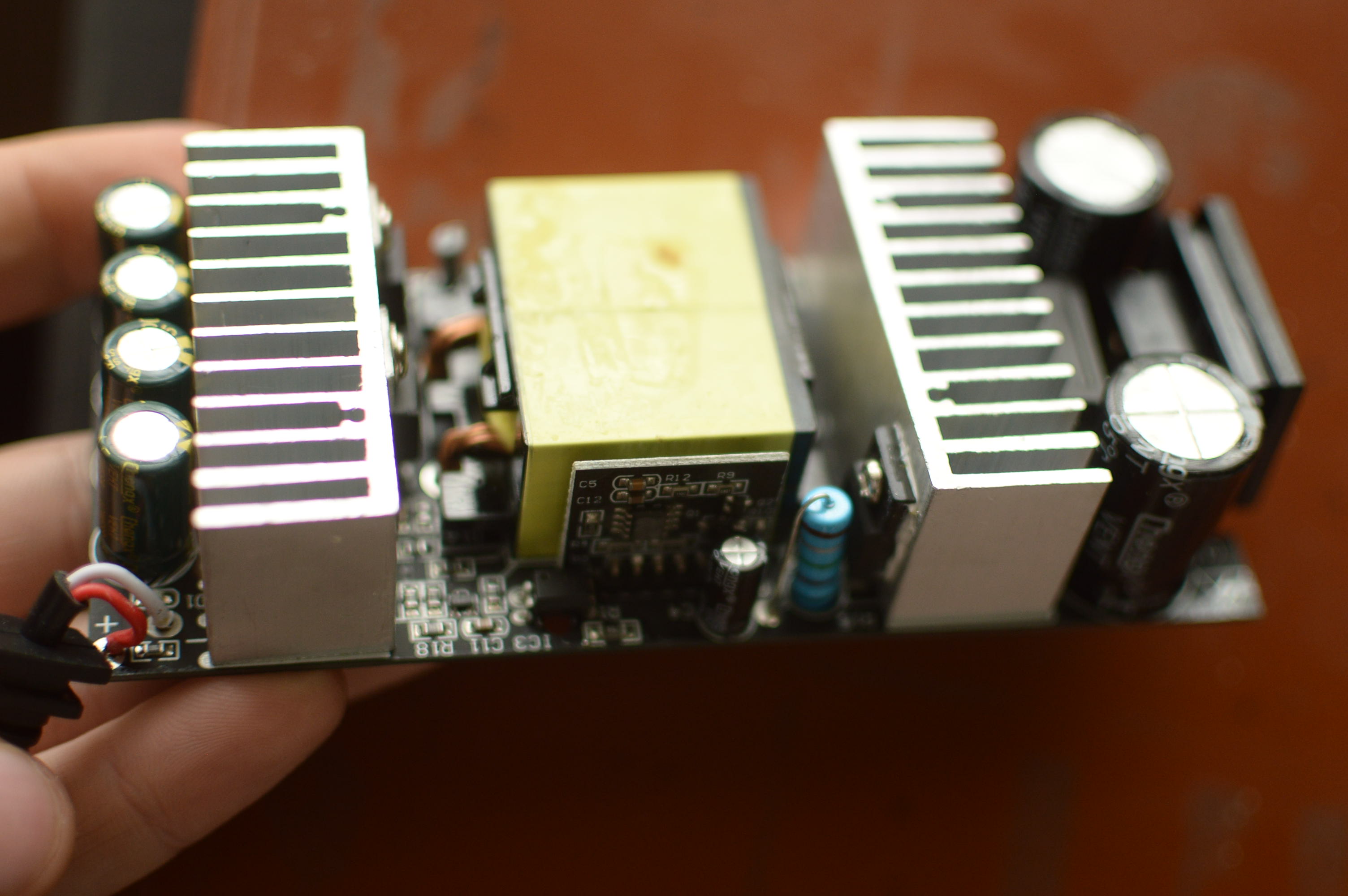

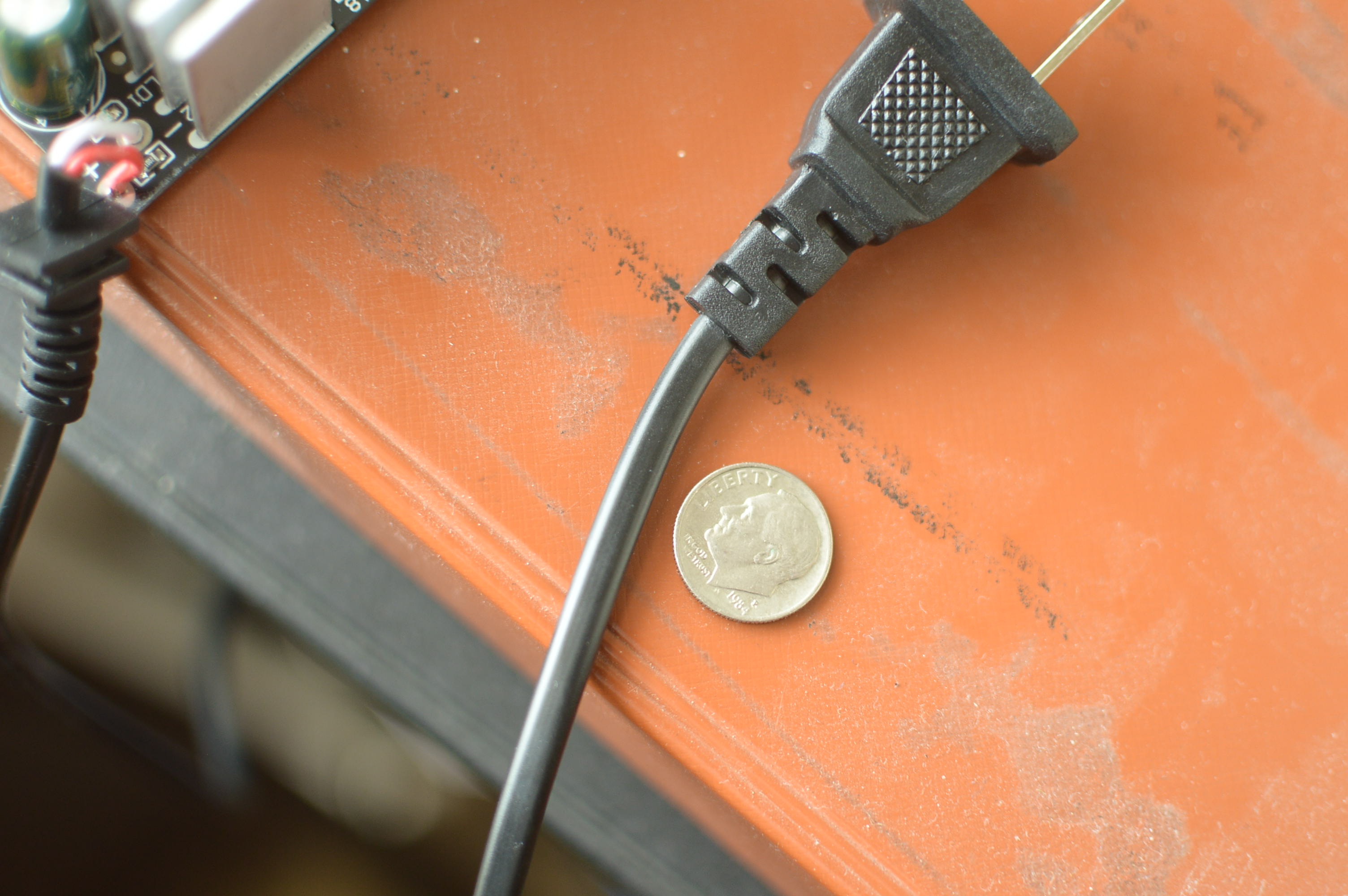

Thank you all in the much needed schooling on what brands to buy and which ones to avoid. After troubleshooting the amp, I found out that it was actually a faulty power brick. Douk Audio 150W 24V/6A AC/DC Power Supply Adapter Transformer US/EU/UK/AU Plug | eBay
I suppose I should've been more suspicious when it claimed it is a 'Real' 24V@ 6A power supply. The electrical outlet plug is not grounded, and it is very flimsy. One review left said that it was noisy.
I tested the amp with a car battery which was out the car and played music through it. At the minimal level, there wasn't any interference or whistling.

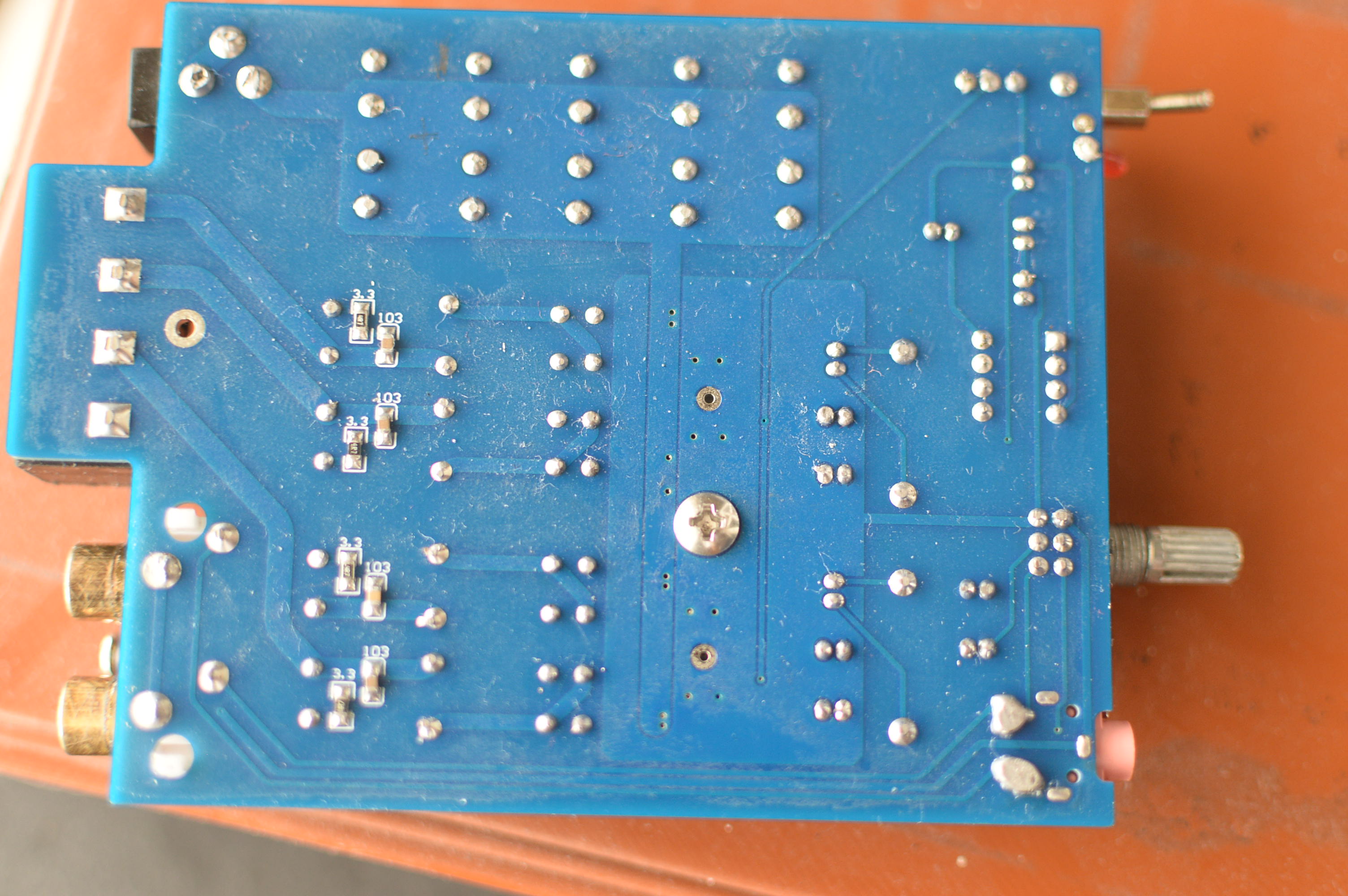

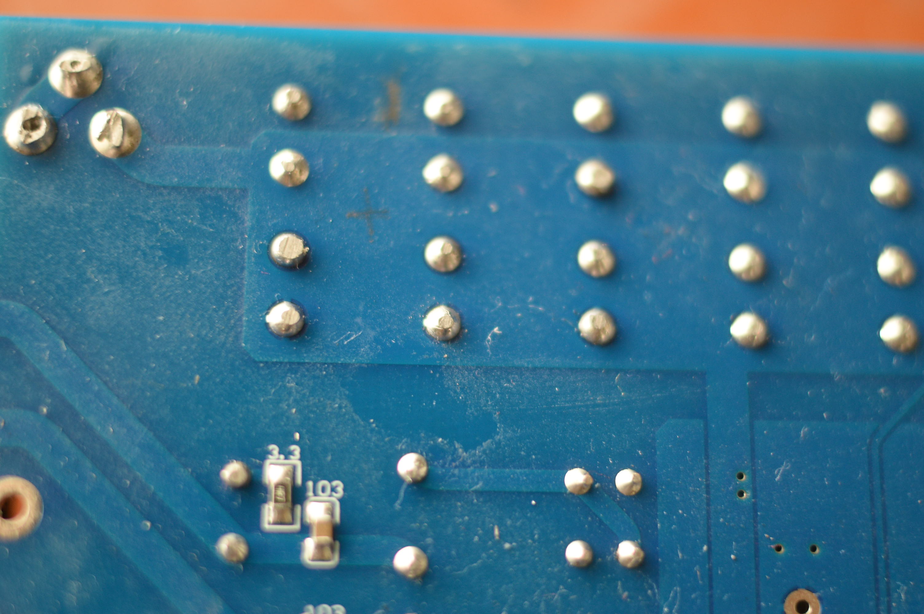

I would like to also replace the capacitors based on everyone's consensus. There are ten 470uf 35 V capacitors. 5 have both leads connected to the positive portion of the circuit board while the other five have the negative lead going to the negative and the other going to the positive etching. I don't know what the purpose is of that is or how to figure out the total capacitance to add in one large capacitor. At first, I thought it would be 4700 uf, but since both leads from the 5 of the capacitors are connected to the positive etch, I'm not sure.

I added some pictures of the power supply and amp board, if anyone is interested.

is it right that really the second row of the caps are shorted??!!
pic 1 and pic 3...??
chris
Hilarious! So they can put the really, really defective ones in that row and they won't blow up [emoji28]
Edit: on closer inspection, the pads on one side are isolated from the large area (barely). Probably they connect with the rail on the other side of the board.
