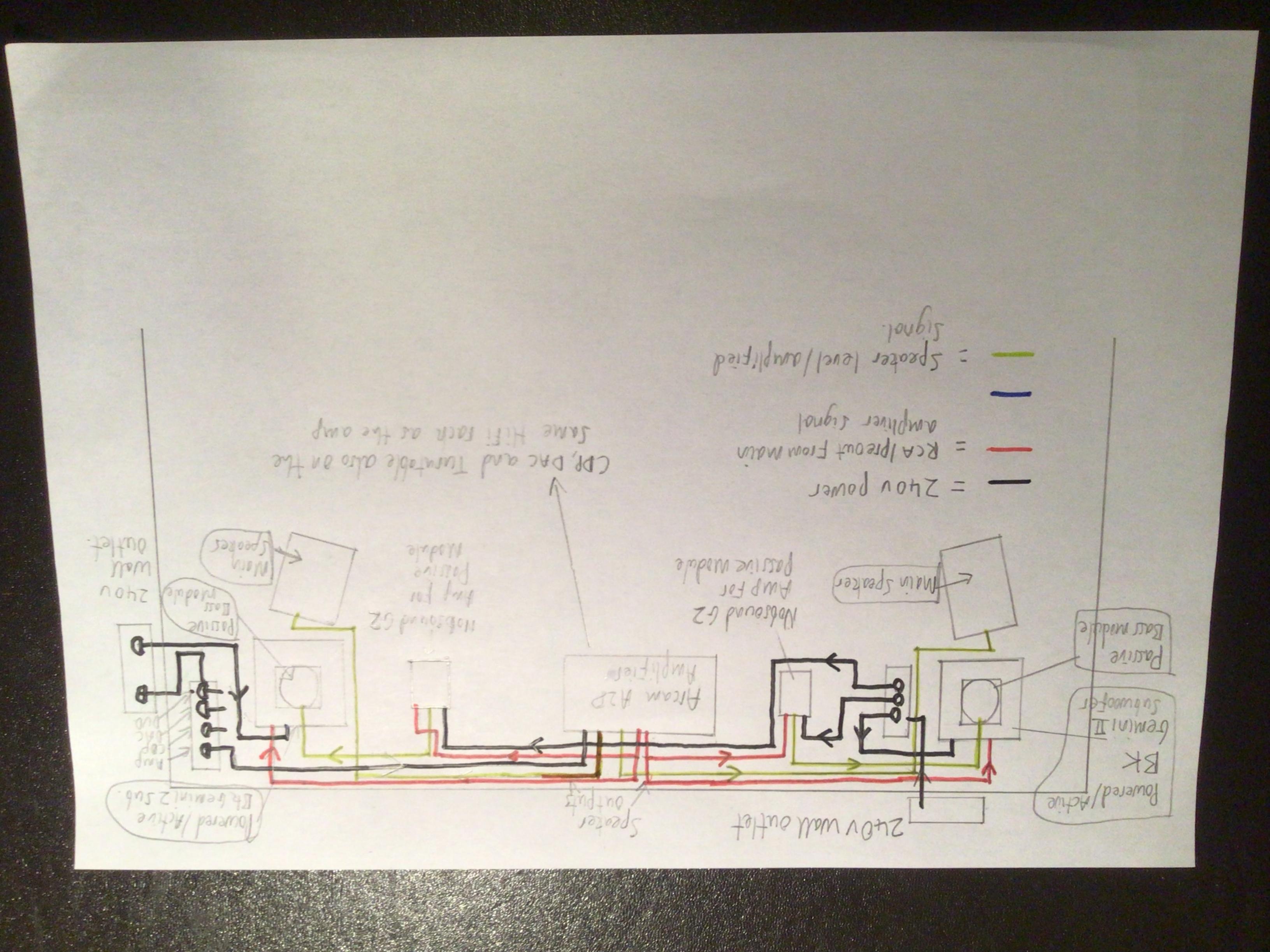

Many thanks. I have drawn a basic diagram of the power, signal and speaker level wiring from the Arcam A28 amp downstream to the BK subwoofers and Nobsound G2 amps/passive bass modules. Hopefully it is clear enough to follow. I made one error when I started colouring the speaker wires (should be CC green) red instead of green. The black lines are power and the red lines are pre out/signal level RCA connections. I use Y splitters (on per channel) from the Arcam amp so that all four bass amplifiers (subs + Nobsounds) receive a signal from the left or right preout pair. I tried the Nobsounds without the Y cables and they still did the same thing!

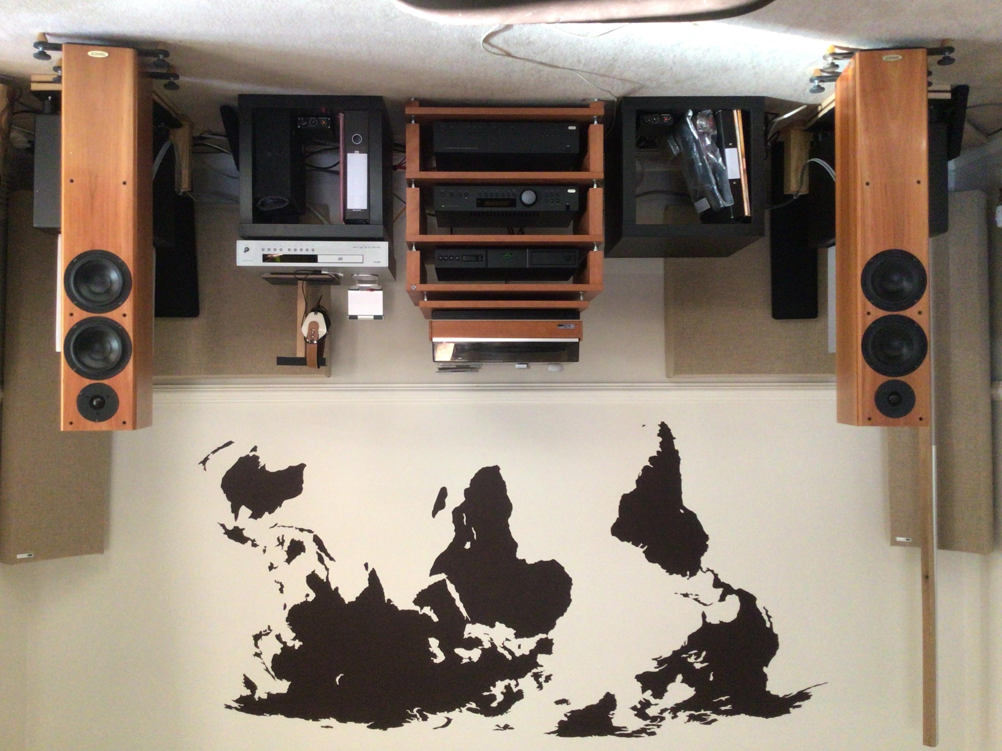

The Arcam amp and the Nobsounds come off different wall sockets but to the best of my knowledge the actual house main is the same. I have also included a picture of the system to give you an idea how it is all laid out.
If you have any questions or ideas, please let me know.
Sorry that the pictures are upside down!

I think the problem might be running a speaker out from the Arcam to the G2. I believe you should run a a signal input to the input of the G2 instead of a speaker output. If you can use a tape monitor or a sub out to the G2 you might solve the issue.
Thanks for looking. Just to clarify, both G2s are only wired via RCA from the Arcam’s preouts. I use Y splitter cables on the Arcam’s preouts so that the two BKs and the two G2s receive their signal at preout level thus system volume is controlled by the Arcam only. The only items linked to the Arcam’s speaker outputs are the two main Tannoy speakers.
Regards
Alex
OK, nevermind. I thought the speaker output of the Arcam was connected to the G2.
You might have already done this, but I would start with nothing connected to the Arcam, then connect one piece at a time. Maybe one of the amps or DACs is causing the problem.
Mike
I’m certain the issue is coming from the G2s. My guess is that they somehow let a big ‘switch-on surge’ through even when they are powered off. It was a loud pop/bang the time I had the volume on the Arcam up. I’m guessing that they lack something on their inputs to stop this switch on surge go upstream through their RCAs - they were cheap but they would be so much better for me at least if they spent just a little more making them ‘safe.’ It’s a real shame as otherwise they performed flawlessly but I dare not risk damage to my other components.
