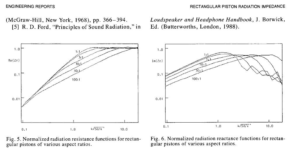

I agree that for the same radiating area tall and thin is always more pleasing to the eye than square. 😉
Fortunately, it also tends to be more pleasing to the ear too with its better horizontal dispersion.
I would be very interested to know the source of the idea that an 8:1 ratio is the optimum.
The real part of the radiation impedance does change more gradually with frequency for line sources than square source. But, I would think the optimum would be an infinitely long line source, not 8:1. See the first attachment for comparison of radiation impedance for different ratios of rectangular sources taken from AES.,Vol.38,No.5, 1990May "On the Acoustic Impedance of Baffled Strip Radiators" Note that impedance comparisons are for sources with the same area. So, for the same area a square radiator will be more efficient at radiating low frequencies than a line source in free space. At very low frequencies the efficiency for square and line sources converge.
But, our listening rooms are not free space.
If you can extend your line source floor to ceiling you will get the benefit of mirroring of the line source from the floor and ceiling. In practice, a floor to ceiling line source will have 3db - 6dB more efficiency at low frequencies(below 100Hz) than a square source of equal area. This may not be important for hybrids, but is a substantial advantage for a FR ESL.
So, as Calvin mentioned, line sources provide better horizontal dispersion and generally as good if not better efficiency at low frequencies.

Looking at comparing radiation impedance for square and line sources with equal width instead of equal area, and the line source gains substantially in efficiency over the square source at frequencies below where phase cancellation begins. In fact, gaining 3dB for every octave lower in frequency. Such a comparison was published in AES Vol. 43, No. 7/8, 1995 July/August, "On the Acoustic Impedance of Baffled Strip Radiators". See 2nd attachment for this comparison.

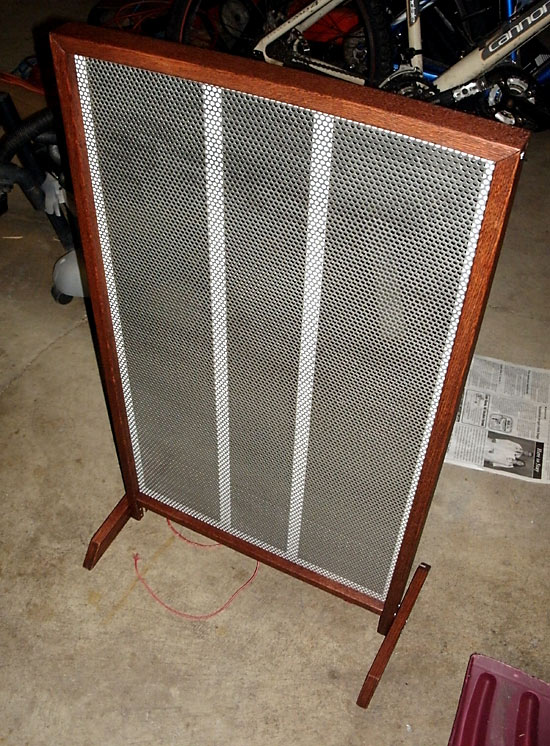

Ok, line sources do seem to have some merits. Otoh Quad's are fairly square so you can probably get a good sounding speaker either way.
In my case, a floor to ceiling panel isn't an option so it'll be something like a 64" tall "strip" panel or a 28"x40" square panel.
Now, I'm perfectly happy with your explanations and the "strip" design is probably easier to build. The only reason I'm thinking about the square design as an option is because it would fit beautifully on top of dynamic bass. (Maybe a TH or a FLH?)

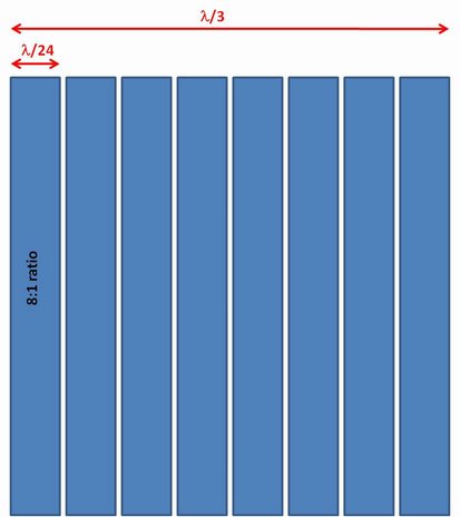

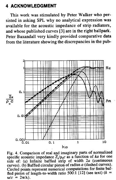

Calvin’s statement about a rectangular ESL with an 8:1 ratio having a real acoustic radiation impedance over its full working frequency range puzzled me greatly.
But, I think I stumbled on the source for Calvin’s statement. And, once the context of the statement is understood, it makes sense.
From "Telstar Shaped Electrostatic Speaker", by R. J. Matthys, Audio, vol. 48, May 1964:
“The diameter of a single electrostatic diaphragm (round or square) is about 1/24 of the wavelength of sound at the diaphragm’s resonant frequency. Since the air load on a diaphragm is reactive and not resistive when the diameter is less than one-third of the wavelength, a single electrostatic diaphragm will see a reactive air load in the frequency range between the fundamental diaphragm resonance and about eight times this resonant frequency.
Walker has shown that an electrostatic speaker reacts differently to a reactive load than does a moving coil loudspeaker…The best solution is to add speakers of the same size in parallel until the diameter of the speaker array is one-third the wavelength of sound at the fundamental resonant frequency of the diaphragm. This solution solves the reactive air load problem by making the air load resistive at all frequencies above the fundamental diaphragm resonance. Another way of accomplishing the same thing is to make the diaphragm rectangular, with the length of each diaphragm equal to eight times the width.”
Attachment (1) shows that for ka>1 (ie diameter > 1/3 wavelength) radiation impedance is resistive and constant.

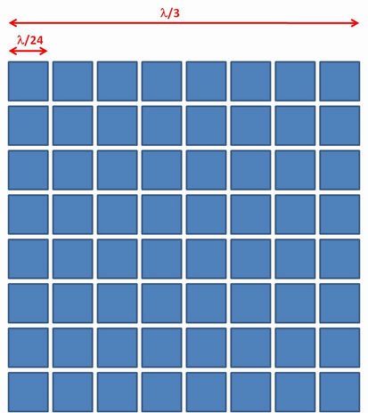

What Matthys said was that it would be possible to combine multiple smaller ESL panels into an array such that the resulting size would make the radiation impedance on each of the ESL panels resistive over their full working range even if this isn't the case when one panel is operated alone. If, as he states for his small ESL panels, the diameter is 1/24 wavelength at their fundamental resonance, an array of 64 panels arranged as in Attachment (2) would provide the desired resistive radiation over the full working range of the ESL panels.
Alternatively, Matthys states(highlighted in red above) that using rectangular shapes ESL strips with ratio of length to width of 8:1 could also be used to achieve the same result.
See Attachment (3).
Note that it is only the array of 8:1 ESL panels that achieves the resistive radiation over the full working range.
One 8:1 ESL panel operated by itself does not.
With just one 8:1 ESL panel, the radiation impedance turns reactive as soon as the wavelength gets longer than the width of the ESL panel, and you get a falling response with reducing frequency below this point. This is the dipole cancellation that we are all familiar with.

A mechanically segmented panel will show the same behaviour as a multiple of panels of segment-size. The single segmented panel though is easier to build, easier in handling and offers smarter optics.
I agree, no real difference between eight 8:1 ratio ESL panels mounted next to each other in a frame or a single square panel segmented into eight 8:1 ratio strips.
The point of the statement was that a single 8:1 ratio ESL panel by itself will not have a resistive radiation impedance to as low a frequency as eight of these panels mounted together. The radiation impedance for the single panel changes from resistive to reactive at a frequency 8 times higher than the array of eight panels(or segmented square panel if you prefer). As such the single 8:1 panel does not couple to the air at low frequencies as well as the large array.
There is nothing special about the 8:1 ratio for ESLs that provides a resistive radiation impedance over the full working frequency range as stated in post #2.

I just got done with my tweet/mid panels (see attached pic). The height:width ratio is 1.6:1 (32 inches high, 20 inches wide), much shorter and wider than most I've seen. I picked this for no reason other than that is essentially the golden ratio (0.618), and building them for tweet and mid which they seem to do beautifully.
The panel is segmented mechanically (3 vertical sections) but is electrically all one. The segmentation was done purely for mechanical reasons - to support the diapraghm so that it is not pulled into the stators. Didn't have any sonic considerations when doing this.
I don't think I will ever be going back to cone speakers.
