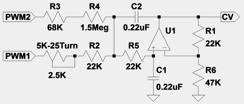

My little project needs 14bits (MIDI to Moog CV/Gate)
Arduino analog writes are only 8 bit PWM at 490Hz.
Dig down into the registers, maybe 12 bits...
So, the thought occurs to me: Use two PWMs and scale
them with resistors. Except the brain dead obvious 256x
ratio is so wide, its not easy to accurately dial in.
But MIDI control is only a pair of 7bits, so only 14bit
DAC is needed for those CV's. And 88 piano keys of
tuning is 186 DAC steps per key, 14bits seems plenty
there too...
So, I figure needing ony 7 bits PWM per analog write,
and a much more reasonable scaling factor of 64x. I
can switch back and forth between the redundant bits
that are within the range of either DAC to tweak 64x.
Now the tricky part. I need to low pass filter 490Hz,
and smooth the most significant bit enough that the
least significant bit isn't lost in the noise. -39dB.
I think a Sallen Key with 2 poles and a knee at 33Hz
can exceed that by a good amount, and 0.05 seconds
portamento to settle reasonably close to a new value.
Looking at 22K for both resistors, and 0.22uF for both
caps. Q is 0.5. I can't tell exact attenuation of 490Hz
from the crude graph, but sure looks to be more than
below the -40dB line...
64x scaling resistor is 1.5Meg in series with 68K.
I need 5K 25 turn pot (set to 2.5K) in series with
my Sallen's first 22K. I think that gives me enough
adjust to get away with worst case 5% resistors.
I'm never going to squeeze 7.33 octaves out of 5V
suppply rail at 1V per octave. But with 9V rail and
if I scale the Sallen's negative feedback, say 47K/
(22K+47K) I can stretch almost that far. Q rises,
but not so much its threatening to oscillate. And
gliding faster between notes, but not significantly
so. Q now about 0.68
Do these numbers sound even close to right???
What sort of data rate and filtering would your 32
bits need for the least significant bit not be lost in
the noise of the most significant bit? Is it a sensible
question, or I am dreaming a non-existent problem?
