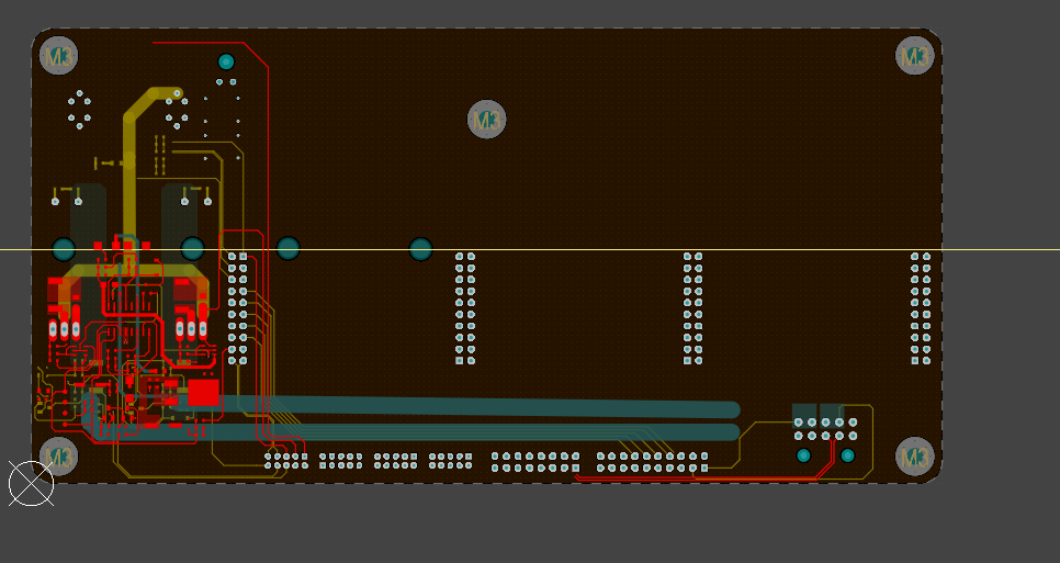

Yeah - I never really thought of things that way. Sitting with x10 IRS20957 chips that's getting a layout for a x4 channel amplifier, Shown: I have Current, Voltage and other things feeding into a external control card (not developed as yet) that will use an STM32H7 and measure across all x4 channels and do ALL things.

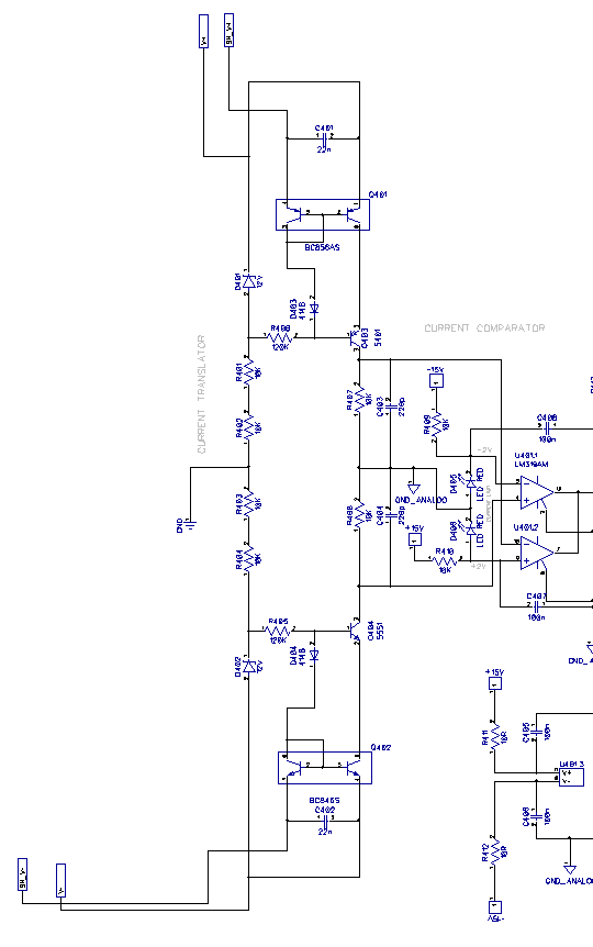

We use SI8234/44 with a small analog current control circuit. The SI8234 is available now for $3.

This is the kind of current control circuit we used. The delay is about 400ns.

In the future will move to SI8234/44 and have the MCU do everything if I was crazy enough I would just build a gate driver using an FPGA/CPLD cool runner but this is overkill. I don't mind writing code on various platforms as long as they close to bare metal and obey and fast reaction ISR pattern things should be portable.

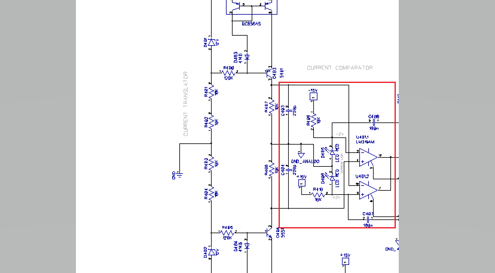

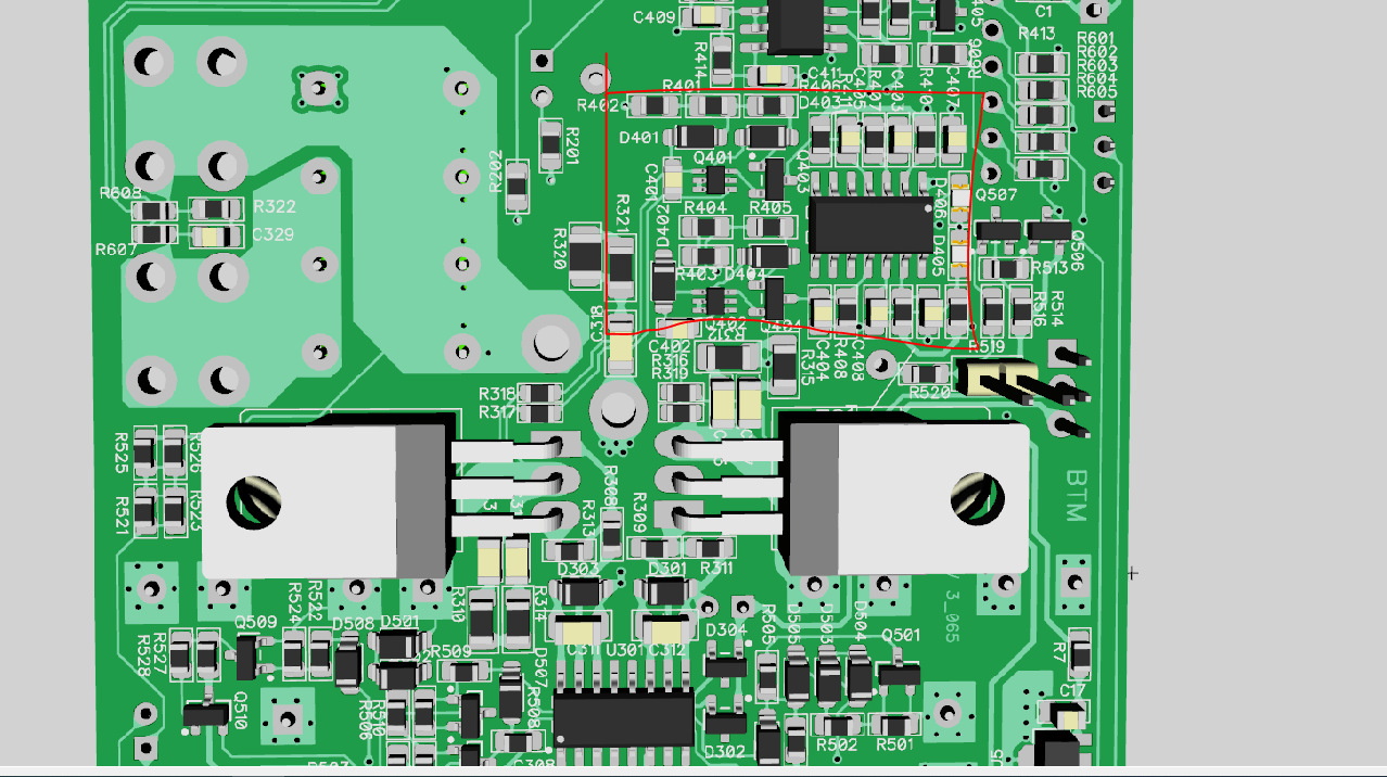

You could remove this comparator setup and have your MCU perform protection evaluation with much more flexibility, replace the red boundary with a TL074 and have the x2 OPAMPs act as a buffer/ gain adjustment/firewall and have the MCU ADC deal with the OC trip points. You may need to write fast code that deals with non-fractional numbers for the fastest reaction speed.
Thank you, of course. However, try running such a circuit in practice first, with the controller 15mm away from the output stage. There are some hidden difficulties here 😉
I think the only workable option is to use an analogue comparator in the microcontroller, but in my case I need two of them. And there's only one in the controller.
