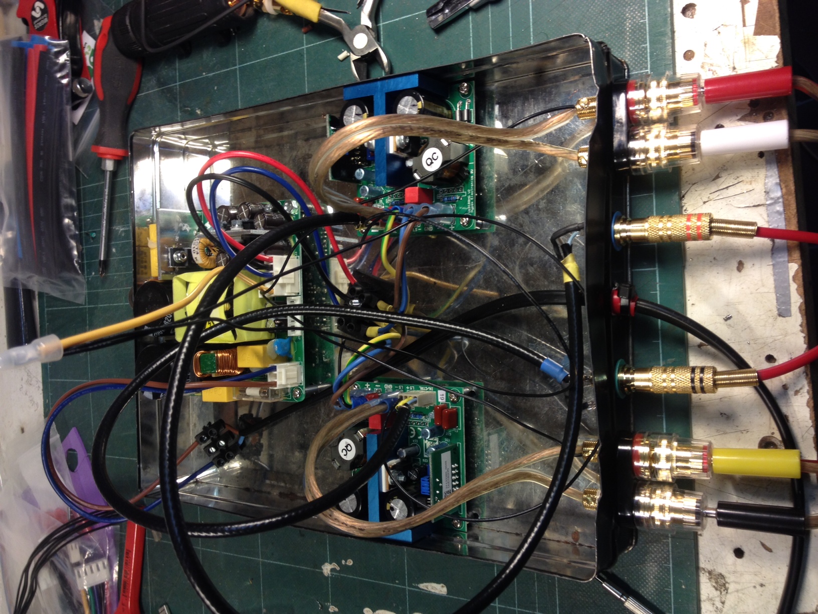

Hi all,
I've put together a build with two UcD180HG amps and one SMPS400. I connected everything as in the diagrams found on this forum but I guess I have messed-up somewhere because there is hardly any sound from the amp. Turning the volume up on the pre-amp doesn't seem to make any difference. I have checked soldering, etc., re-checked the diagram but still no success.

Update: I've re-wired pin 4 (J4) to the GND. Sound is a little louder but still very muted.

I'm unclear why you've wired UcD pin 4 to ground. Both of those should go to the yellow wire on your SMPS and nowhere else.
The blue lights on the modules are turning on? You've checked for +/- DC power from the PS module?
Since you're using unbalanced inputs you should be on Pins 1&2.....Pin 3 should be open.

Success, it finally is working !
Thank's for that. Pin 4 (UcD) is back on the yellow wire on the PS. That was the initial setup I had. Not sure what you mean by Pin 3 open ? I have the shielded cable from Hypex which has a shielding and two cables in the middle. One of them is on the + of the RCA and the other together with the shielding on the chassis. I think this is what Hypex recommends.
In the meantime ....
In a last resort attempt I took the whole box upstairs where my main stereo is and hooked it up.. guess what.. it works !
I still have to figure out what was causing the problem, but I suspect that it was either a faulty pair of (old) loudspeakers I was using for the test or the LS cables...
