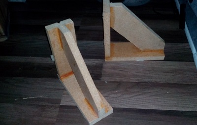

Ok, now that that bit of inclement weather has blown by, let's see if we can pick up this thread again. My first cab build was a 2x16" closed bass guitar cab. Having read much about the importance of weight and stiffness, I built it like the proverbial Brick $#it-house: 9-ply 3/4" eucalyptus plywood, 2x4" battens all around, 2x4 bracing, a gallon of Elmer's and 2" #14 countersunk screws every 6 inches. Even put glue in the screw-holes with a syringe. It broke chunks off concrete steps and bent the steel pipe handrail when it got away from us after a gig on the third floor of a converted warehouse. Luckily, the drummer heard it coming and, hugging his bass drum, leapt the last six steps.... I cut the cab in half soon thereafter. One half still sits where I parked it decades ago. I later made several smaller cabs out of MDF using smaller battens and fewer screws. Still very heavy. My latest cabs are made of 3/4" spruce board, butt-joined with 1"x3/4" battens simply glued and pinned with an air nailer. Much lighter than plywood or MDF, and plenty strong. I'll build my next one even lighter, using 1/2" spruce. I'll X-brace the back panel if it seems too flexible. In my experience, there's little to be gained by building a massive cabinet. Light and stiff works just as well.
I concluded in my experience that even 2x2 battens all around its an excess, I used them before just because I thought their mass would be convenient when screwing and joining all the mdf boards together, otherwise I would not use them, for corner bracing I instead would use 3/4x3/4 by some inches or even all section, this being a plus after joining all the boards with miter joints.

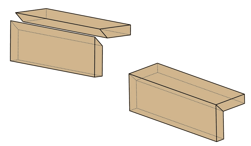

Think about this, if we use 3/4 MDF, and do simple joints, the glue touches 19mm section only, but when we do miter joints, the glue now covers 28mm of section!!! which obviously result in a better and stronger joint, now with this simple method, screws would not be necessary at all. Only minor problem with this is that you need at least 2 angles to hold all together while glue dries, but I think is a lot worth it.

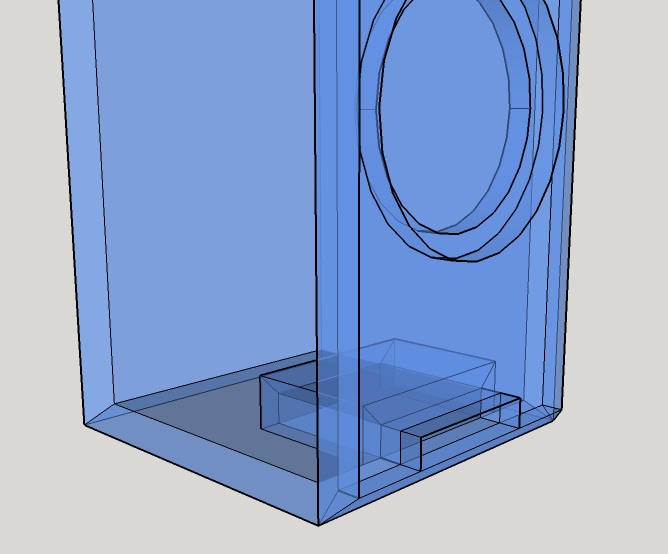

I just designed a one foot enclosure for a 8" subwoofer, and will miter join all the boards, and maybe not necessary but I made some little pieces of 19x19x80mm to brace along the edges.
