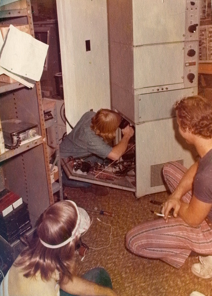

I found 3 old pictures from back then, 2 of me wiring up his Gates TX, and one of me holding up a fluorescent bulb near the antenna on his car....there was a Collins TX in the back seat.

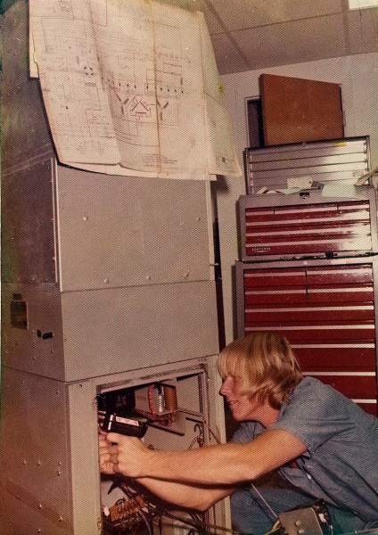

Note the 3 phase power supply schematic hanging from the top of the Gates HFL-3000. My task was to make it run from 240 volt single phase power without blacking out the warehouse complex.
