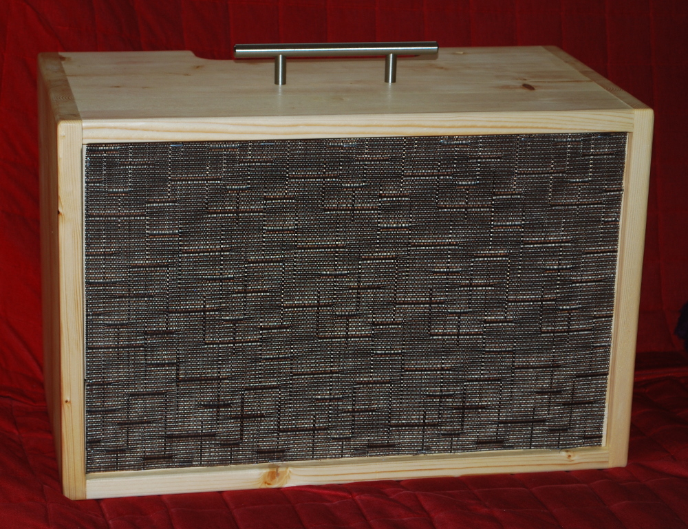

The dollar stores are still open here. You and I have both used place-mats for grille cloth before. The combo guitar amp in the attached pic uses a dollar-store place mat for a grille cloth.
Michael's (arts/crafts store) is also still open around here. They often have rolls of mesh fabric in several colours, usually used to make decorative backdrops for weddings and other celebrations. They make good grille-cloth, too - I had to double up the cloth to get it to show some colour (dark blue) and not bee too transparent in the last cab for which I used it.

I like that one, do not have it. Been there done that. I have a supply of place mats to use, just not big enough for this project. My first place mat grill, I used some stain to age the look of it to match the condition of the radi😵ther than places that sell food here and hardware stores all stores are closed.
