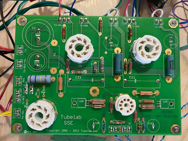

Hi All,
So this is my first electronics project and I am an absolute beginner with all this stuff. I have spent the last couple months putting together George's Simple SE. tried to start my checkout today by metering between R4 and ground. When I turned the power bar on nothing happened. No voltage reading, no light, no smoke. I have two ideas of what it might be besides the fact that I have no idea what I am doing.
Firstly I purchased an on-on switch by accident. I may have wired this wrong. I wired the middle prong to the opt, and the bottom prong to the fused plug.
My other thought might be the empty sockets labeled D4, D3, and TR1. I saw in some other threads that these need diodes and a in-rush current limiter. Is that still the case?

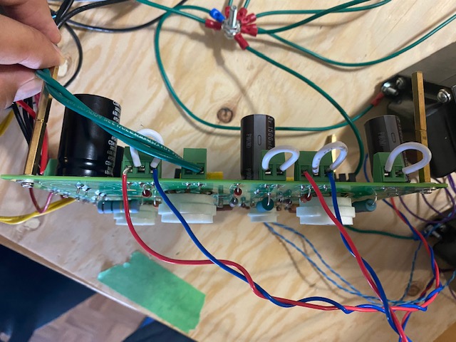

That switch with the main voltage in pictures 3 is dangerous. insulate that wires as minimum and mount the switch firmly. Also the big cap must be securely mounted.
Then check all the wiring with the schmeatics...
Remove the tubes and go slowly, steep by steep...

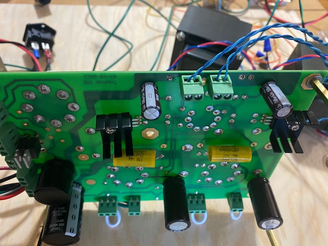

This is still the case, yes.
Start here & populate with the 2 diodes & inrush limiter. You can use jumpers to test if you wish, but that defeats the (important) purpose of George's board change.

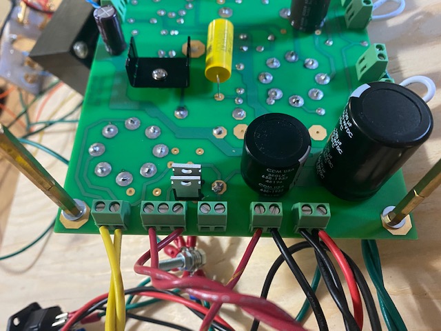

Wow. First project, eh? Welcome to the big leagues of B+ of 350 VDC or greater.
Well, unplug the whole thing if you haven't already, drain the capacitors with a resistor so you don't get any surprise shocks, remove the vaccum tubes, and take more pictures of the underside of the board, the top side minus tubes, and the wiring from the PT and OPT iron.
Next, do you have a checklist of components installed, a checklist of things to do in order, and whatever else maybe that you wrote down? Have that handy. It will be a nice reminder to say what you left out and what you added.
Some clarification. You said you powered it up the first time. Did you power up the whole thing the first time using a variac or a simple dim bulb tester? If so, what were the readings from your voltmeter when you were slowly powering it up? These things keep parts from frying because frying can be very noticeable with smoke and scorch marks or something almost invisible.
Information (as much as you have) because people don't have x-ray vision and no one else was there to see steps in assembly or the power up. The information helps because it could be one missing component or one forgotten solder joint.

Thank you for the advice. Regarding insulating the switch connections, can I just use electrical tape temporarily? Once I have tested everything I will be building an enclosure and was going solder some of the connections and use heat shrink over them.
As stated, a pair of 1N4007 or UF4007 diodes and a CL-140 current limiter are needed in the missing component holes. They can be replaced with a wire jumper for a quick test, but this places extra stress on the rectifier tube.
Did the internal heaters glow orange inside the tubes after a minute or so? If so, then the missing parts could be the only issue.

Hi Overtheairbroadcast,
Yeah, first one. May have bitten off more than I should chew, but I'm here now.
I checked all the capacitors before I tried to drain them but they were not showing any charge on my multimeter. Everything has been unplugged and the tubes removed.
I have attached my BOM. I borrowed it from Mmcaleer, and made a few changes due to availability. As far as how i went about installing things, I essentially followed the instructions on Georges website.
When I powered it up I just put my multimeter on between R4 and star ground, had it plugged into a power strip and flipped the switch. As I did not see a voltage reading after a few seconds or smoke I powered it down.
