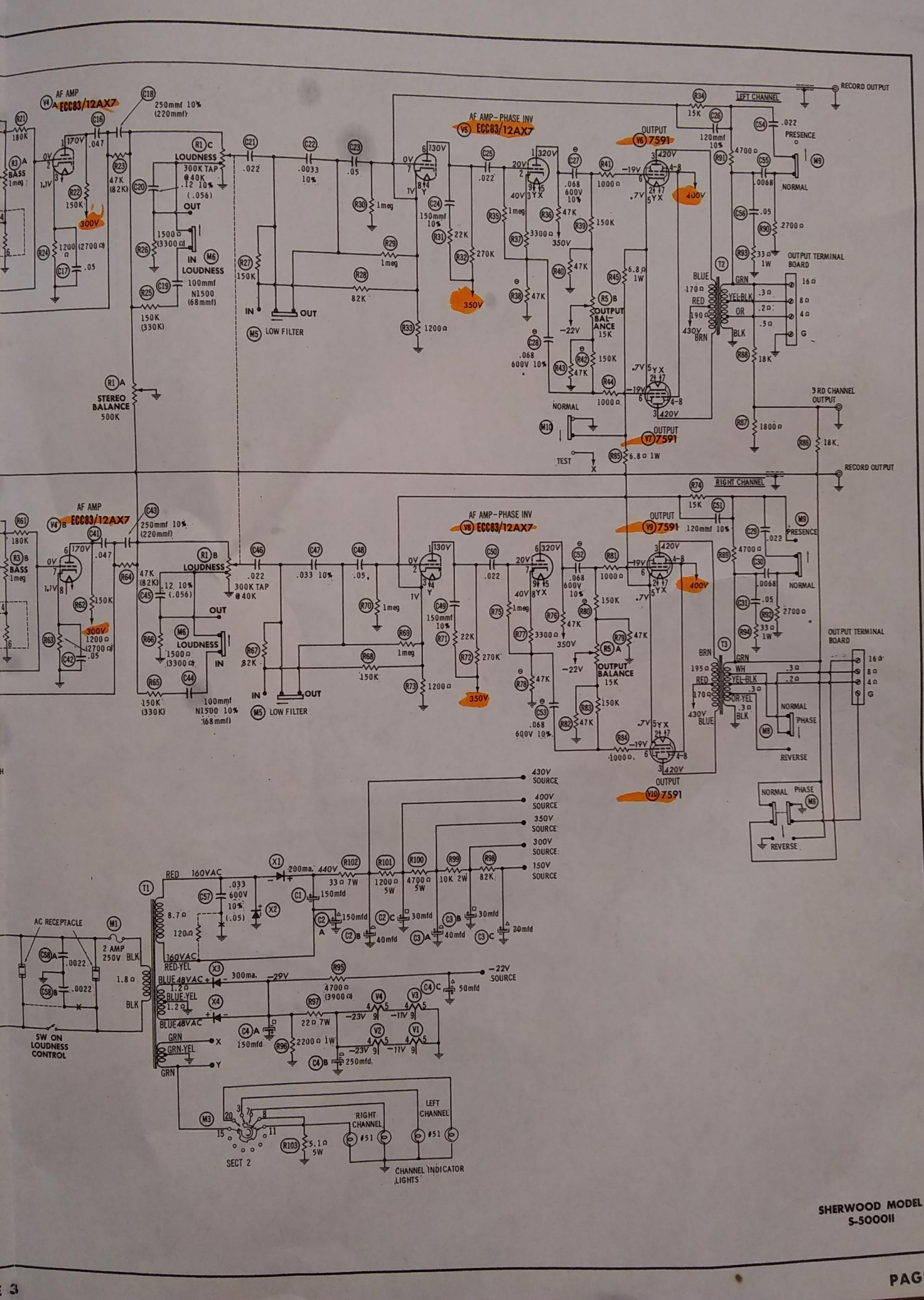

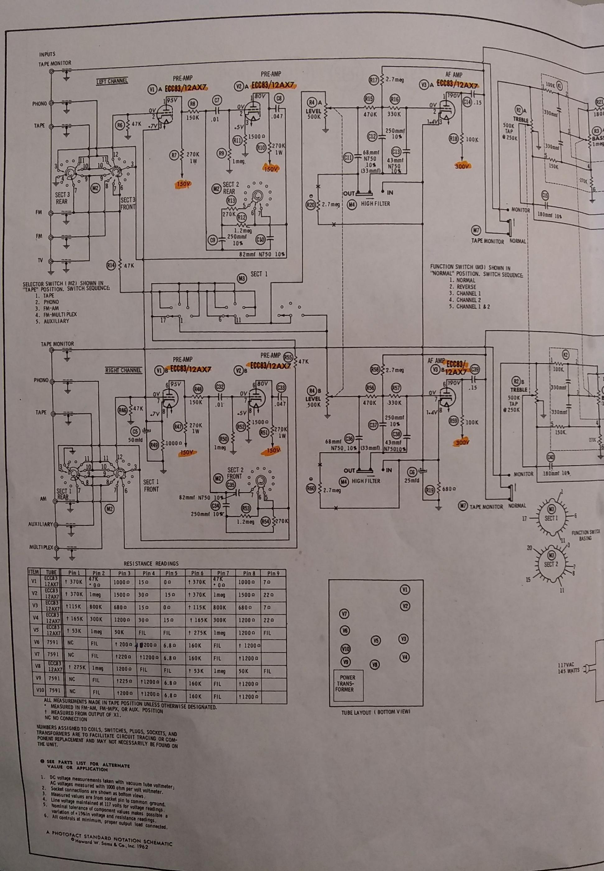

no output right channel Sherwood S-5000ii
When I set the function switch to "Ch 1+2" I get sound out of only the left speaker, but it is getting signal from both inputs as I use a "left-right" audio track. I know the inputs are working.
Ha! Solved!! Thank you for your advice. After I checked the transformer and several caps and resistors I went back to that danged tape selector switch and really gave it what for. I had de-ox'ed it once already but as it turned out that's all it was. I'll tell you one thing, this is a beautiful sounding amp especially in stereo. Thank you to everyone who contributed suggestions!
