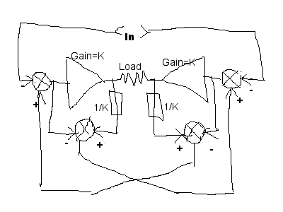

thanh said:have you known a amp which can cancel distortion absolutely?
why don't you try to simulate with my topo or unitgain?
I've tried to simulate my topo for a very basic Class B amp. It didn't work, inderstandably. When the input crosses 0V, both halves of the bridge can do very little about correcting each other's crossover distortion. It might work better in Class AB, especially if the two halves are differently biased (their xover points will be in different places so they could help each other in reducing this kind of distortion). I'll try to do Classes AB and A later.
This whole circuitry thing is kinda new to me, I'm learning my way as I go, so please bear with me if I don't make much sense.

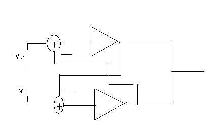

error amp have got its distoriton So i suggest sym topo ,
http://home.kimo.com.tw/skychutw/Circuits/Idea/X-BTL/X-BTL.html
what do you think about these topo?

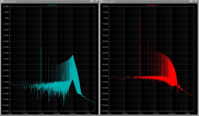

I think it goes up because the amp is too slow, and no good at all to begin with. The distortion should be re-amplified, but the amp does it slowly and not very accurately. With a faster amp the figure will go up too, but at much higher frequencies, perhaps 100k or more. I'll try it with other designs when I get some free time.
Also note that, though it goes up, at 20k it's still 15dB or so lower than the uncomensated figure.
thanh said:error amp have got its distoriton So i suggest sym topo ,
This is basically equivalent to my topo, only simpler. But mine can be used with an existing amp when you can't access its feedback circuit.
the distortion output is the distortion of error amp if the cancelling is absolute.But the error amp is also normal amp so it also has got distortion .I want a topology which can cancel the distortion of the error amp
I think there is a killer amp on simulated sofware.There is not a killer amp in the real world .Because components are different or not similar.
