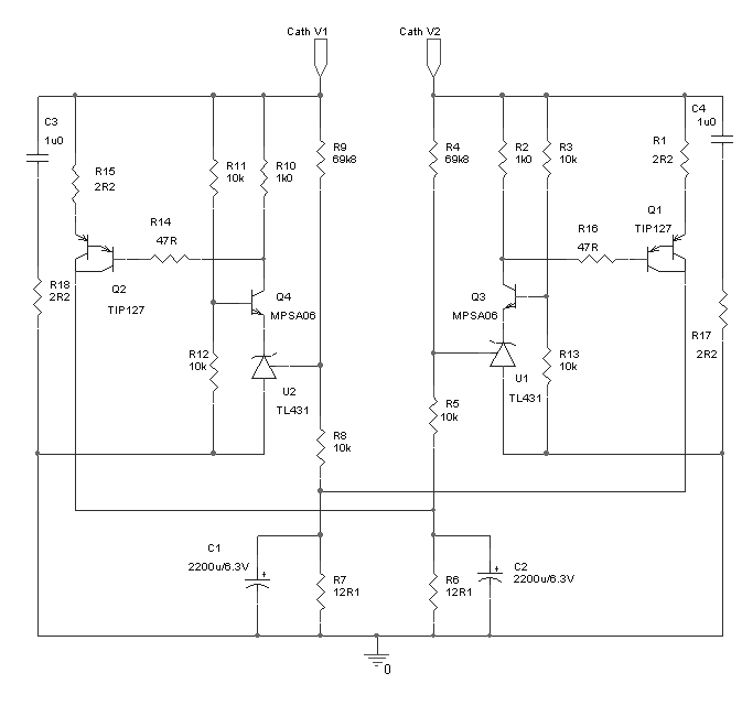

There's been some discussion in another thread regarding the Blumlein "Garter Belt" bias scheme that helps to correct output tube mismatching. Posted is a circuit that combines this scheme with an active cathode bias circuit, sacrificing some of the advantages of that bias circuit, but eliminating a bias balance pot - food for thought. Values are TBD, just the concept is presented for now.

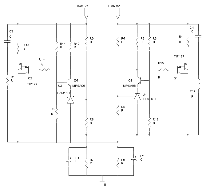

I sat down and did some thinking about what I needed for a Garter Belt" NLD bias circuit. Assuming the plate voltage for the 6CW5s is ariound 250 V, about 16V of negative bias is needed for a plate current of 40mA. I made an E-WAG and and decided that the Garter resistors (R6 and R7) would need to drop 20% of the 2.5V reference voltage of the TL431 at 40mA. This works out to a resistance of around 12 ohms. Bypass capacitors C1 and C2 need to be out of the way at audio frequencies of interest. I chose a corner frequency of 5 Hz. This gives me a requirement of ~2700uF. I have some 2200 uf/6.3V low ESR caps around, so I'll try those. The resulting schematic is shown. I'll try populating the circuit with some random 6CW5s and see how well it balances, and whether the TL431s will need additional compensation (some like to take off and oscillate at a couple of MHz, so that they give squirreley results while appearing to sort of work).

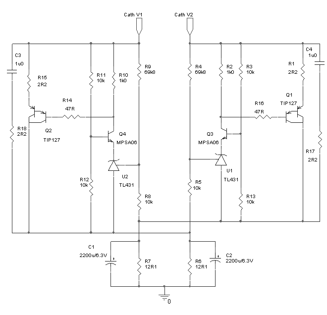

Itested a breadboard of the "NLD Garter bias circuit yesterday, and caught a mistake in grounding that essentially nullified the "garter" part of the circuit. The circuit should look as shown here instead. The gounds on the TL431s are shifted so that they can "see" the voltage on the garter resistors. I've made the changes in my breadboard, and will try it again today.
I'd hold on to your horses until I get this thing built, so I can test it with an actual audio signal. The 6CW5s used in the test were actually tolerably well-matched out of the box, so I want to try subbing some more tubes to get some that aren't matched as well. I have some 8CW5s of different brands, so I could try them while I'm bringing up the amp on bench supplies. I may or may not want to change the "garter" resistor values (R6 and R7) depending on the results of that testing.
But, to answer your question somewhat, you choose an operating bias current for your tubes and look up the required bias voltage from the typical curves. The divider resistors for each TL431 (R4-5, R8-9) are set for the proper voltage drop, taking into account the voltage dropped across the garter resistors. If you are unsure of how to calculate the resistor string, you may want to start with a simple cathode bias network as shown in the schematic in post 13 - easier to build and understand. The first thing you want to do, though, if you haven't done it already, is to download the spec sheet for the TL431 and familiarize yourself with how it operates. It's a variable shunt regulator, and the Darlington pass transistor is used to increase the amount of current it can handle. The cascode transistor cleans up some aspects of the transient response and increases the voltage that can be handled by the bias circuit, as the TL431 has a maximum operating voltage of 35 volts or so.

Anyway, I nailed myself big time this evening by constructing my NLD/garter bias boards using TLV431s instead of TL431s. For those not in the know, the TLV431 has a 1.25V reference voltage vs the TL431's 2.5V reference. This explains why my amp was drawing 1/2A of bias. Fixed that... Next up, the EI/Yugoslav 6CW5s I'm using are a little friskier than average, and need some more bias to calm them down. I'll fix that tomorrow, then debug the input stage.

Last weekend, I spent some frustrating hours with the No-Light, crowned by the decision of one of the Yugo 6CW5s to go red-plate above ~250V (my first red-plate event). The Blumlein garter circuit in this version of the NLD has a lot of gain, and if one tube goes bad and draws a lot of current, it pushes up the other tube quite a bit, and depresses the bias voltage - positive feedback in the worst way. One solution is to reduce the value of the current sense resistors in series with each tube to reduce the sensitivity and bias adjustment range, but this then requires a huge value for the bypass capacitors (try calculating the cap value required for a 5Hz roll-off with ~3.3 ohms resistance). The amp has been a little hard to stabilize as well.
After the red-plating started to occur, I got disgusted and decided to back off and cool my jets for a bit. Three decisions came from that quiet time - one, ditch the Yugo 6CW5s and get some real ones from Stan - they're on their way. Two, get rid of the Garter bias compensation for this edition of the NLD, as it doubles the circuit complexity and makes troubleshooting a real exercise in frustration. I've come up with some simpler bias boards based on this decision. They are all populated and waiting to be patched in once I get some real 6CW5s. The bias point for the real tubes will probably be a more reasonable 16V or so. Three, add local feedback resistors from output plates to input plates to provide a short feedback path for a good portion of the excess gain. Hopefully, this will make the loop easier to stabilize.
