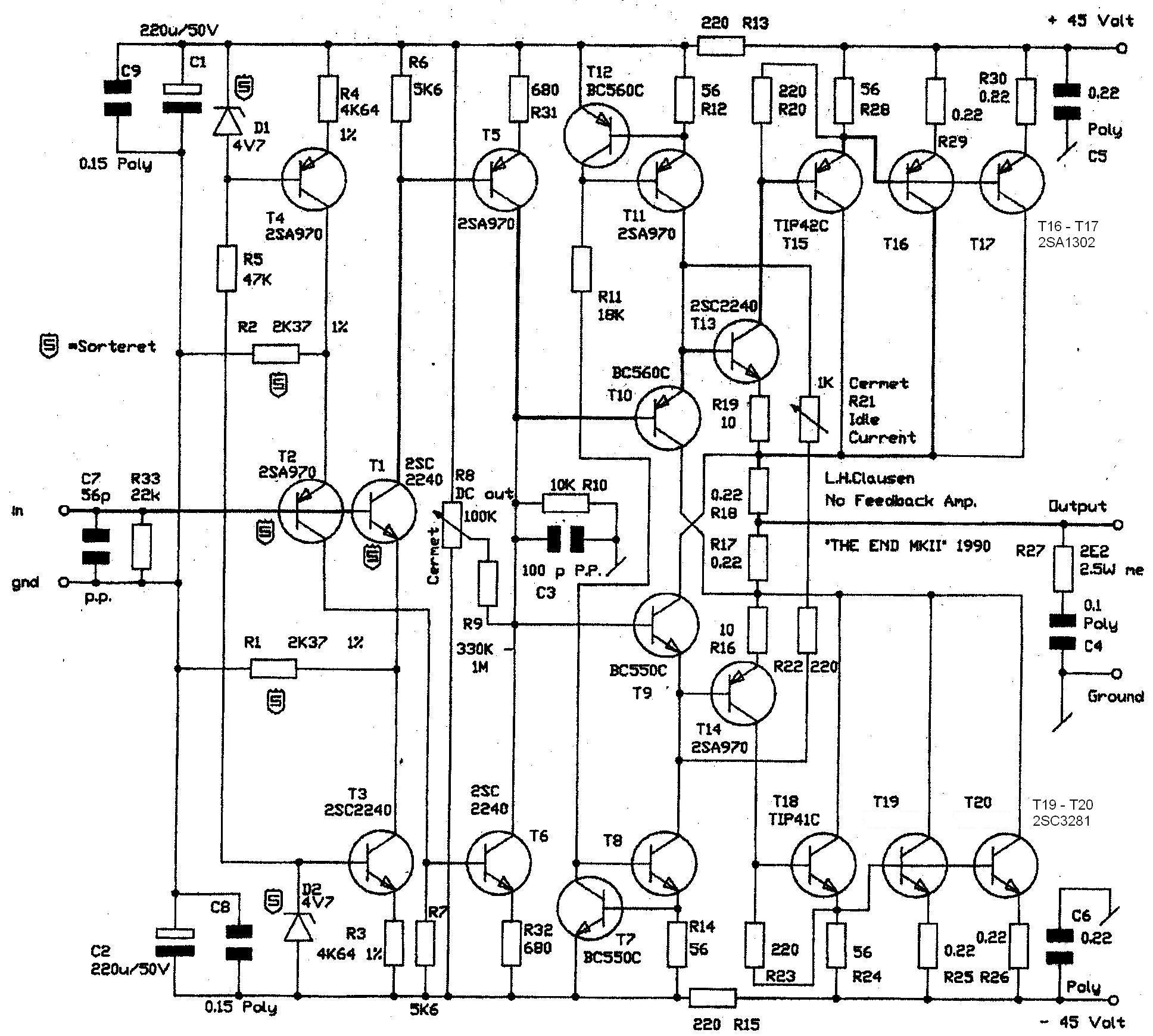

No - feedback amplifier
Search for a no-feedback amplifier showed the attached circuit from
TUBEAMP
What about the design? Want's to built a new amplifier.

Local feedback
Well I'm sure it will sound good.
Technically, it isn't a no-feedback design - there's lots of local feedback / degeneration; has to be to get good sound.
But it certainly is a non-GLOBAL-feedback amp.

Ok, thanks.
I was told that amplifiers without FB sounds well. So - local FB can not be avoided concluded out from your statement.

Forgot to ask.....do you prefer a symmetrical solid state design?
Just short....symmetrical or ?
Well, I find it difficult to say that a particular topology is better or not. You can make great symmetrical amps and great non-symmetrical as well.
So much depends on the circuit details and the implementation.
Things like the grounding layout, (remember, not all grounds are created equal!) or power supply decoupling, and supply routing probably have at least the same impact as the topology.
If you are not experienced in those issues, your best bet for a successfull implementation is to selct a design that you like and where the designer gives info about how to put it together, and follow those.
With a circuit like the one you showed, and good implementation practise, your amp will certainly sound very well.

Understand....well , I have made some amplifiers, and know that the wire connection from PSU to the PCB might affect the stability of the outputstage...also depending on the ground layout as you mentioned.
I shall stay with the symmetrical design...it looks good... from my point of view.

I guess LC knew something you don't. LOL!
If LC refers to me I can assure you that I never used TIP type of BJT's anywhere. BF471/472 in my schematics are completely different kind of animals, for pre-drivers only. :D
For drivers I would certainly recommend something like 2SA1930/2SC5171. ;)
And for outputs not a crap as 2SC3281/2SA1302 but something like 2SA2121/2SC5949. ;)

Plenty of feedback, just not the usual type. Looks like current rather than voltage feedback. Why on earth would you choose to use crap like the TIP41/42 as drivers to 2SC3281/2SA1302's...
A little research showed that faster drivers in the mkII version could make the circuit unstable.
It seems that L.H.Clausen changed drivers as well as o/p transistors in the mk3 version, which I found at the same site.
As to your statement concerning 3281/1302, the mentioned powertransistors has been used more than once, and messured linearity of the Toshiba's equals the types that you suggest.
