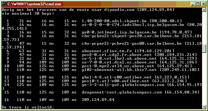

Traceroute command:
Go to Start->Run type Cmd --> OK
Type Tracert www.diyaudio.com --> Enter
If the final ip address is 209.124.89.84 you should be able to reach this site. IMHO 🙂

Traceroute command:

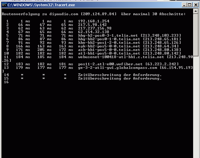

I think Ipconfig returns 192.168.1.254
So you should "ping 192.168.1.254 -f -l 1412"
Now you're tracert is weird.
The route seems to go all the way just before the diyaudio server.
I guess this is something for the real guru's...Audiofreak? Where are you? 🙂

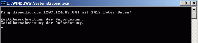

with "ping www.diyaudio.com -f -l 1412 -i 200"
i get timeout also.
were should i change something?

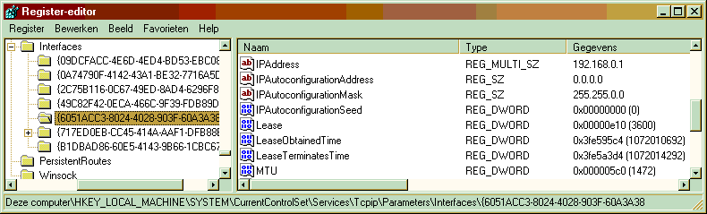

Here’s how to change the MTU in the registry:
As Billy says: Careful with that Axe, Eugene 😉
Basic:
Win2K/XP. Don’t know for Win98/Me or other systems.
Determine the correct MTU value with ping.
Go to Start->Run --> Type ‘Regedit’ --> Enter
Go to: HKEY_LOCAL_MACHINE\SYSTEM\CurrentControlSet\Services\Tcpip\Parameters\Interfaces\
Several subkeys will appear.
Choose the one were you find your Ethernet card IPAddress: 192.168.x.x
On the right pane of the window, right click and choose New->DWORD-value.
Name it MTU.
Go to your windows calculator, set it in scientific mode and enter the correct MTU value.
Mine would be 1472
Now click on Hex. The calculator should return the Hex value of 1472 witch is 5C0.
Go back to regedit, double click on your newly created MTU key and enter the Hex value from the calculator.
Done!
Close regedit and restart the system.

till said:with "ping www.diyaudio.com -f -l 1412 -i 200"
i get timeout also.
We tried another computer behind same router and got also timeout connecting to diyaudio.
Sorry, I was half asleep when I typed that... try
"ping www.diyaudio.com -f -l 1412 -i 200 -w 10000"
and
"tracert www.diyaudio.com -w 10000"
and pls post the results.

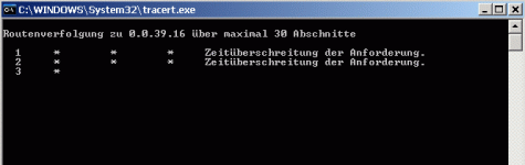

till said:"tracert www.diyaudio.com -w 10000"
Ok, something's up with those tracert results. 0.0.39.16 is the default address when you dont enter a FQDN or IP.
