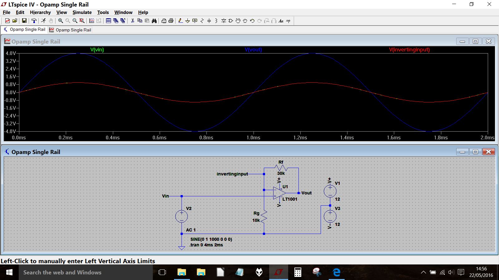

Look again at Mooly's post19.
Assume the output has moved to 1.0000Vdc
The resistor ladder forming the feedback is 3k0 and 1k0 to the gound symbol.
That 1.0000Vdc on the output divides down to 1.0000/(1k+3k) = 0.2500Vdc between the resistor and 0.0000Vdc at the ground symbol.
That 0.2500Vdc appears on the -IN pin of the opamp.
Using that "rule":
The output moves to a voltage to try to make the two input pins see the same voltage, we arrive at the same 0.2500Vdc apearing on the +IN pin.
You have three voltages on the signal pins.
Do they make sense?
The gain of a non inverting opamp is {Rupper/Rlower} + 1 = 3k/1k +1 = 4times
4times 0.2500Vdc = 1.0000Vdc
YES !!!!! it works.
