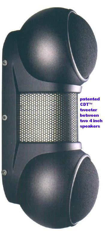

Crossover-Less Speakers
I'm told by a someone at Gallo Acoustics that their TMM monitors (gallo reference) has no crossover of any kind, their proprietary tweeter has some way of passing only the HF band with out any passive devices. I believe their new "Due" are of the same topology.
Re: Crossover-Less Speakers
I believe the Gallo's use a piezo tweeter. No crossover required.
kingdaddy said:I'm told by a someone at Gallo Acoustics that their TMM monitors (gallo reference) has no crossover of any kind, their proprietary tweeter has some way of passing only the HF band with out any passive devices. I believe their new "Due" are of the same topology.
