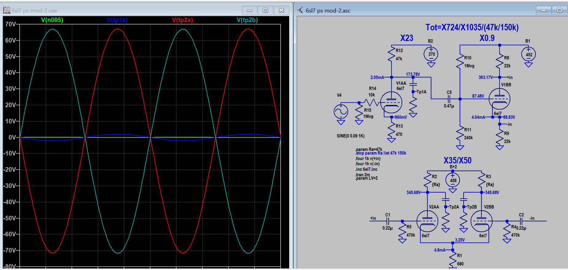

The voltages in the cathodyne stage (V1BB) don't look right to me. According to the schematic the voltage drop over R5 is 227 V while that over R6 is only 50 V. This would result in 10.3 mA through the upper resistor but only 2.3 mA through the lower resistor, which would ofcourse be impossible (unless there would be about 8 mA of grid current running). Normaly the voltage drops over the load resistors in a cathodyne stage should be the same. The voltage drop over R23 + R24 is 452 V. So the current through R23 + R24 would be 0.36 mA (provided there's no grid current flowing from V1BB). That would give a grid voltage of 87.4 V, while the schematic states 48 V.
The voltages around V2BB don't look suitable to me. According to the schematic the anode to cathode voltage per triode is about 340 V while the voltage drop over the anode resistors is 112 V (so the current per triode is 2.38 mA). The cathode voltage would than be (2 x 2.38) x 680 = 3.24 V. The loadlines for the anode resistors would run from Va = 456 V to Ia = (456 / 47K) = 9.6 mA which doesn't seem right at all for a 6SL7. The values of the anode resistors seem too low for a tube like the 6SL7 (that value should be about 3 x the internal resistance, so something like 150K).

Additional: The capacitors in the B+ line are rated for 350 V (first stage) and 450 V (second and third stage). Some of the indicated voltages are a bit higher than 450 V so this already is a bit tricky (and something I would never do myself). If at start-up B+ comes up before the tubes conduct, B+ will temporarely be higher than the 470 V indicated in the schematic. This would be dangerous for the above mentioned capacitors, especially the one rated for 350 V (when B+ comes up fast, the full B+ will be over this capacitor in the period the tubes don't conduct yet).

I plug in your sch components value apparently working, but the operating point measurement differ as PFL200 pointed out. The open loop gain is over 700 so maybe you need to reduce the gain by 10 with gNFB, down to 70 should be reasonable.
Based on the simulation of koonw the cathode of V1BB sits at 89 V. That's very close to the maximum cathode to heater voltage for the 6SL7 (90 V according to most datasheets; some state 100 V). In action, the cathode voltage will swing up and down, so it will rise above above 89 V. If the filament supply of V1BB is grounded, the cathode to heater voltage limit will be exceeded.
