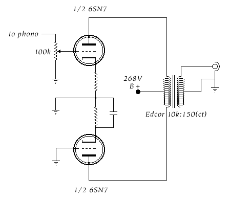

Yesterday, I swapped out the 6J5 cathode follower that is my line stage for a push-pull stage based on a Schmidt phase splitter that drives cheap Edcor line transformers(see below and here) .
Well, it worked - sort of - but there is literally no bass. I bought the Edcors to try something like this as a proof of concept. Yes, they're cheap, but they're only driving my amp. Other than the transformers, is there anything that I might have done to cause this?
Could it be the highish Rp of the 6SN7? Would a 6BL7 be a better choice?
thx,
pete

No wonder.
1) lose the current source
2) feed it with a proper phase splitter
3) use a decent transformer. Crap tranny = crap sound
Geek said:No wonder.
Yes - wonder - stated specs: 20-30k +/-.5dB ...sounded like a 1st order x-over had been inserted@~200Hz
Current sink needed (see thread below).
Proper phase splitter (see same thread below).
thanks for the input
compact amp thread
ps - got some semblance of bass by upping current sink to 20mA.
