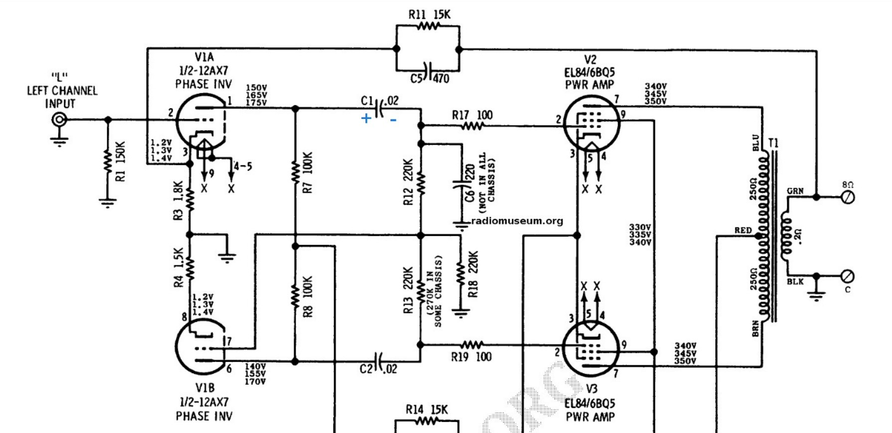

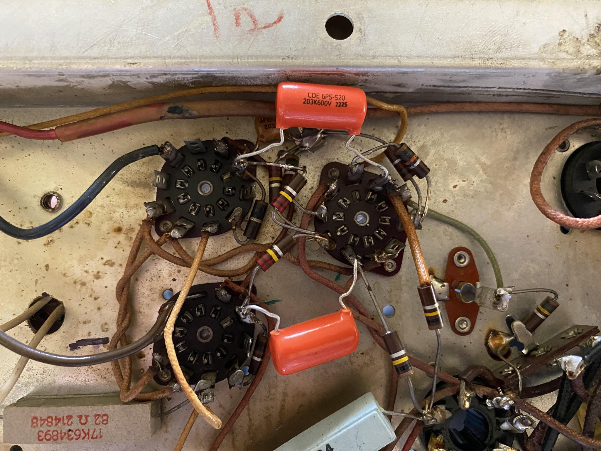

I recently tried swapping out 65 year old electrolytic coupling capacitors from a Motorola HS 711B stereo tube amp. After installing the new caps on one channel of the amp, I no longer get an audio signal, just static from this channel. Any suggestions for troubleshooting this? It's not a high value amp so I'm only using Orange Drop caps. There are no markings for polarity so I'm not sure if that's going to make a difference here.

A schematic and/or a pic of the connections close up might help.

Can't see nothing wrong, unless there'ss a short to another wire, hard to see, but you probably checked that.

Check the value of R17-R19 (100 ohms resistors on pin 2 of the output tubes). One of them looks discolored. They may open if the tube is faulty (internal shorts) or, on this kind of sockets, if the tube is inserted in a wrong way,
That's it, obviously. Have a close look at the photo. There's no pin of neither tube inserted into the contact where the capacitor is soldered to.

It looks like a tube pin contact but it is a tie point instead. The wafer on the top side of the socket does not have a hole in that position, or at least should not have it.
pcan is correct - The pin configuration of the tubes will not allow them to go in any other than they are. Additionally, they are aligned the same way as the other channel (which works fine).

In the picture it looks like the top 100 ohm resistor is bad. You can test the value with the power off overnight and compare it to the other channels 100 ohm resistor.
The other issue is the bottom left new capacitor solder joint doesn’t look bright and shiny.

Yes, it's easy to be fooled by images but the soldering on both replacement caps just doesn't look good enough, whether it makes electrical connections or not. I imagine that the new work hasn't received enough heat and flux to flow the solder properly and make nice, shiny fillets which show good solder flow and adhesion to the wires etc. If you have used lead-free alloy solder instead of 60/40 for example, that requires a higher temperature which might explain the problem.
