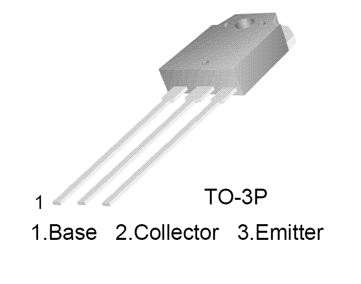

I just received an e-mail from the product line manager at On Semi. Here's what he had to say about these parts:
"Our roadmap for the coming year is centered on the TO-3P package we are getting ready to introduce. This portfolio of devices uses the same die as our TO-264 parts. The lower cost TO-3P package will hopefully allow us to capture more of the cost competitive mid-range consumer business without sacrificing performance"
I'm a bit confused. What's the difference between the MJW (1302/3281) and NJW series? Just TO-247 vs. TO-3P? I don't see much difference between the two in terms of physical footprint. Is there an electrical difference?
Obviously the NJW is smaller than the MJL series TO-264 package, but doesn't the MJW series already provide the size advantage they're after?
Or is there more to it than I'm seeing?
..Todd

An effective difference in parameters other than Vcbo/Vceo seems to be in the 0302 vs 1302 (0281 vs 3281, resp) varietes, the "0"-version are smaller die (less Pd) and have less capacitance. For same number devices vs. case style (NJW, MJL, MJW) I see no significant differences (besides Vcbo/Vceo)
- Klaus
Did anyone else notice that the Rth(j-c), power dissipation, thermal derating and maximum power dissipation don't add upp for many of the ONSemi plastic parts? (MJL21193, MJL3281...)
Rth(j-c) is stated as 0.7K/W and thermal derating as 1.43W/K. This would suggest a power rating of 180W. Or a typo as this is the same values as stated for the 250W metal cans.
Strange is that the mjw3281a datasheet says 0.625K/W (this works out to 200W) but the MJL3281 in the bigger TO264 says 0.7K/W. I have a hard time believing that the smaller package has better thermal properties... 😀
I wonder too what is the advantage of TO3-P vs. TO247. Maybe it is cheaper in some way. Or maybe it's just the japanese transistor looks they are after 😛

Thank you for contacting ON Semiconductor
We have some inconsistencies in our Data sheets. We will be checking all our Audio products data sheets and we?ll correct as required.
