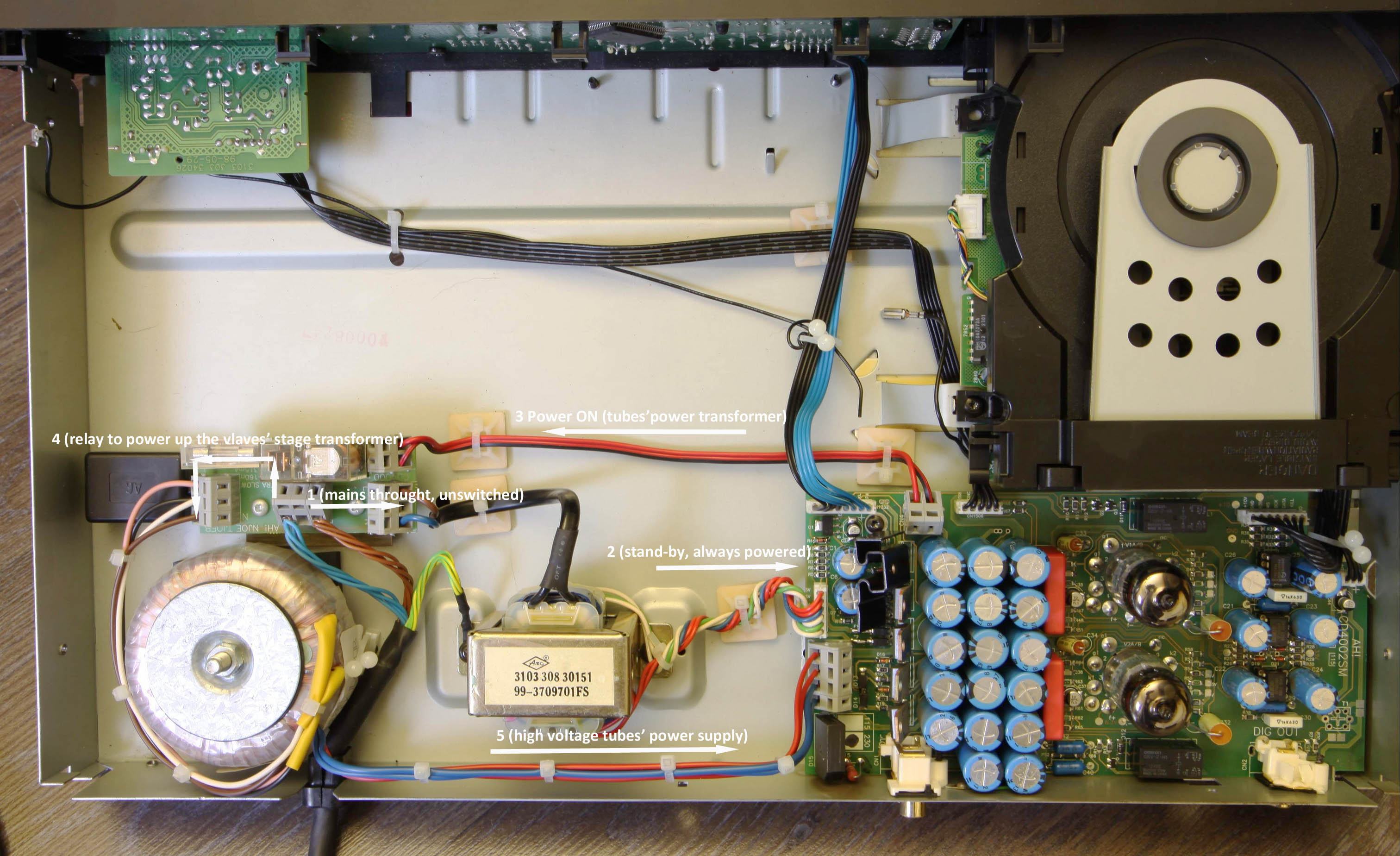

I think my Njoe Tjoeb 4000 CD player muting relay might be going on the blink - periodically the sound will randomly mute, accompanied by a soft click from the player. The disc keeps spinning/playing. Usually the sound will come back after a couple of seconds (with another soft click from the player), but at least once it has stayed off longer and pausing/unpausing the disc immediately fixed it. Typically once it's done this it will then work perfectly until the player is switched off, it's never gone wrong more than once in a given listening session!
Does this sound like the correct diagnosis? Anyone experienced anything like this? Could anyone recommend a possible remedy - could the muting relay be repaired or replaced? I am not an experienced modder but perhaps at least knowing what the issue is, I might be able to take it to a repair shop? With it being an unusual player I am concerned that a mainstream repair place would not know what to do - if "CD player repair" is even still a commercial possibility these days...

Look at arrow No 3.... the relay drive voltage might be unstable. There are additional 2 black relays that are doing "digital" muting; the control signals come from that short-loader uPC IC (located underneath the mechanism)

Thanks - I suspect it's the "digital" relay that's at fault.
I assume the "big" relay goes on and off with the player, you get a big click with that one. Then when playing/pausing a disc you get a small click - that's the one I hear when the player goes silent on its own. Also pausing/unpausing the disc brings the sound back, probably because it resets the relay? In addition, the sound goes INSTANTLY on and off, if the tube stage was losing power I'd expect a more gradual fade.
The next question is, even if I knew that was the fault, what could I (or a qualified technician) potentially do about it? Presumably it's either the signal that is sent to the relay or the component(s) not quite performing correctly. What could be done in either case? Does anyone have any pictures or information about these components?

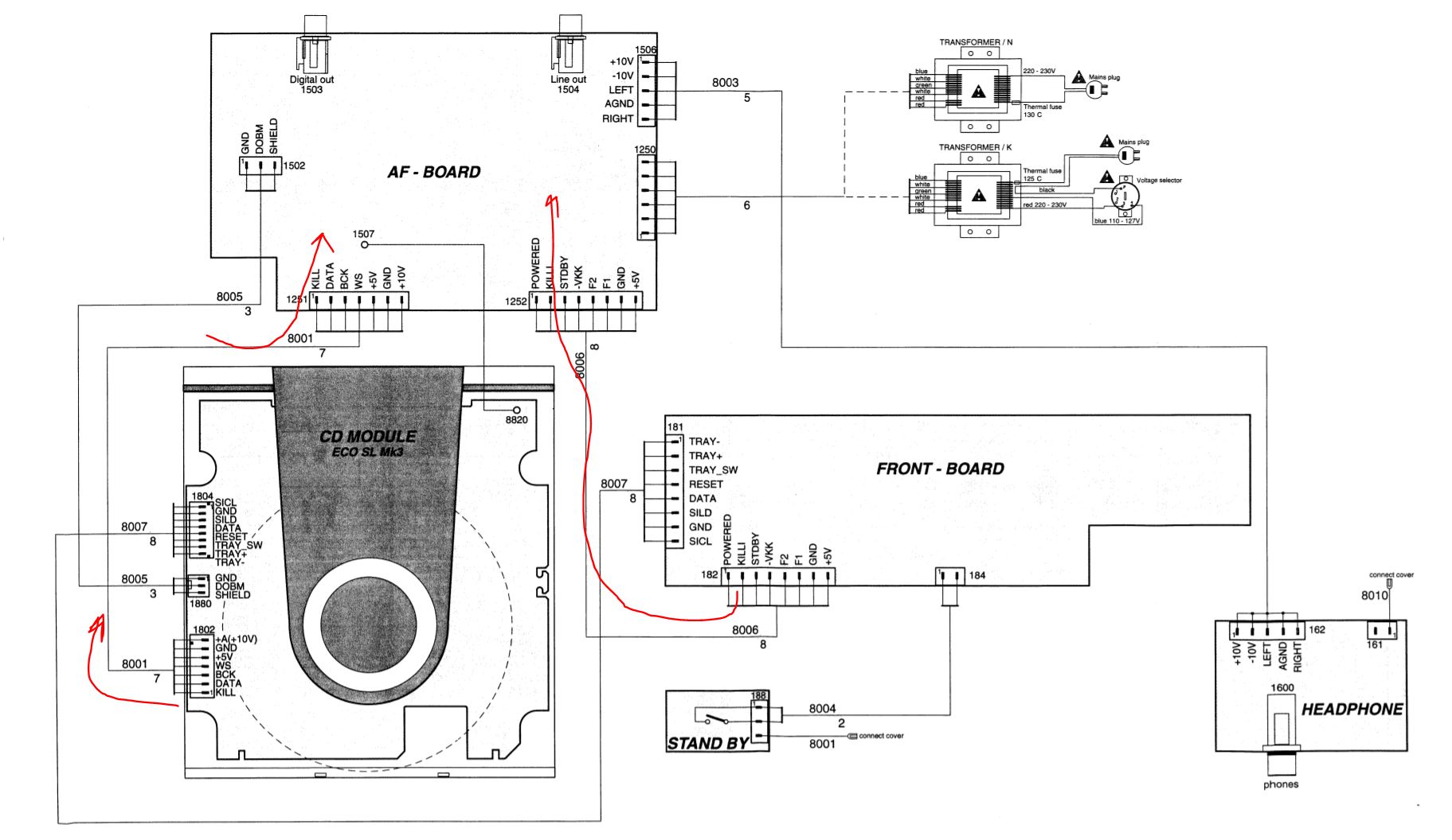

The KILL signal comes from few places. From the CD mechanism PCB (mounted underneath the mechanism) and from the front panel (8-bit CPU). See Capture.jpg
The service manual for CD4000 is available from few places - I downloaded it from HiFiEngine. If you are not confident (or if you don't have the equipment to test/ capture the fault instance)... take the CD player to a service technician. Hopefully, he'll fix it for you.

Thanks for the diagram, very useful - would the fact that there are 2 "digital" relays but both channels always mute/unmute together indicate that it's the KILL signal that's at fault (rather than the actual relays)?
Then it becomes about which of the other parts is sending the signal in error and why...I do have a spare transport mechanism but am reluctant to replace that as in terms of spinning and reading discs the current one works perfectly.

You could download the service manual as explained already. Then have a look at KILL sources (I have also pointed this out already...).
You could monitor & record the KILL signals with a 2-channel oscilloscope (the source of KILL signal is multiple, at least two sources... also mentioned already) with a record function. A cheaper option would be a PicoLog 6 and associated hardware; here you can have many channels of simple monitoring and historical trending (i.e. the record function on cheap).
