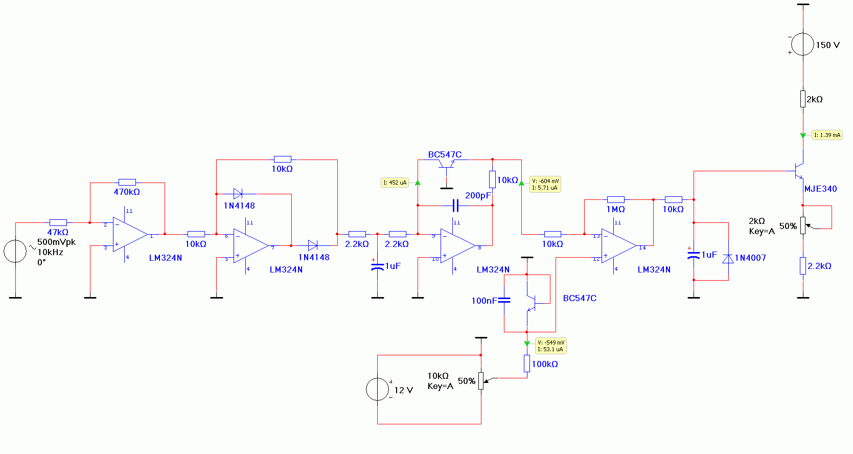

I once built one with cheap parts I had laying around.
The IN9/13 tube here is represented by a 2k resistor.
Only problem i remember was the lin/log conversion (the opamp with two transistors) wasnt very stable. You need to glue the two transistors together for temp correction.
If I had to remake it, i'd simply use an old radio tube: EBF80
If you are using balanced signals in all your amps, like me, it's a piece of cake to design a circuit to use this tube to drive an IN9/13
