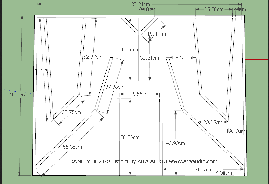

For my hornresp model, I used this folding that I found online. It's a different folding then what I posted about five years ago.(1)
For the driver, I used the B&C 18TBX100. I think that this box will likely work with a variety of eighteens. It's a fairly straightforward FLH from what I can see, just very BIG :O
Sooo, I'm thinking about building this clone of the BC218 for at festival (because I like the directivity), but I started thinking about what happens to all of the heat produced by the voice coil in the back chamber? It doesn't have anywhere to go, and thinking about hitting the drivers with 600 watts makes me kinda scared of the long term consequences..
I've already modelled the speaker in fusion360, so I'm hoping your simulation is in the ballpark of the real life performance ;)
