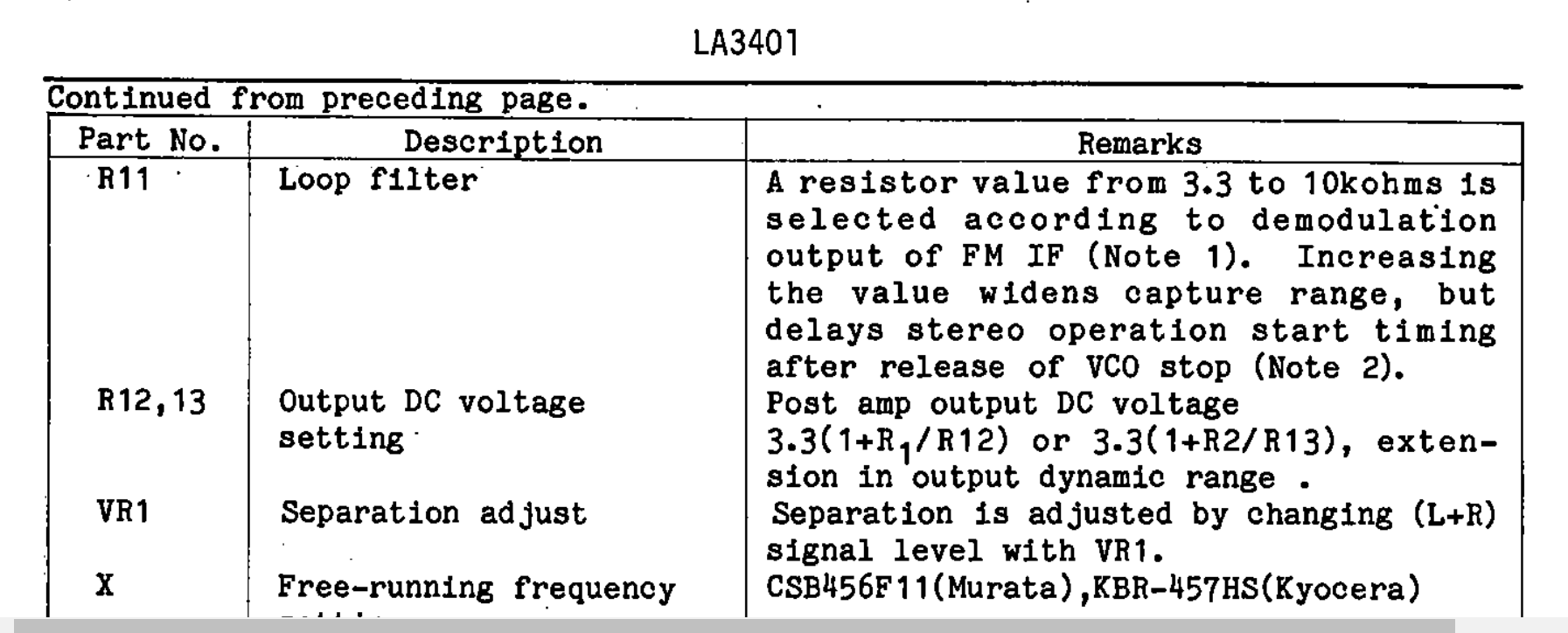

So the signal is coming to the stereo decoder LA3401, but there is no decoding
Measuring 8V on to pin 5 (signal from LA1235) instead of 3.2V according to data sheet for LA3401.
I will test triggering stereo and performance with different values of components from data sheet.

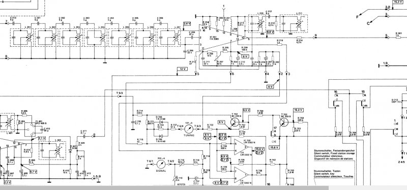

Here is a schematic of Dual CT1640.
I would like to hear more about its front end.
It looks like 7 LC resonance circuits without amplification between what I consider as better from my basic knowledge and intuition.

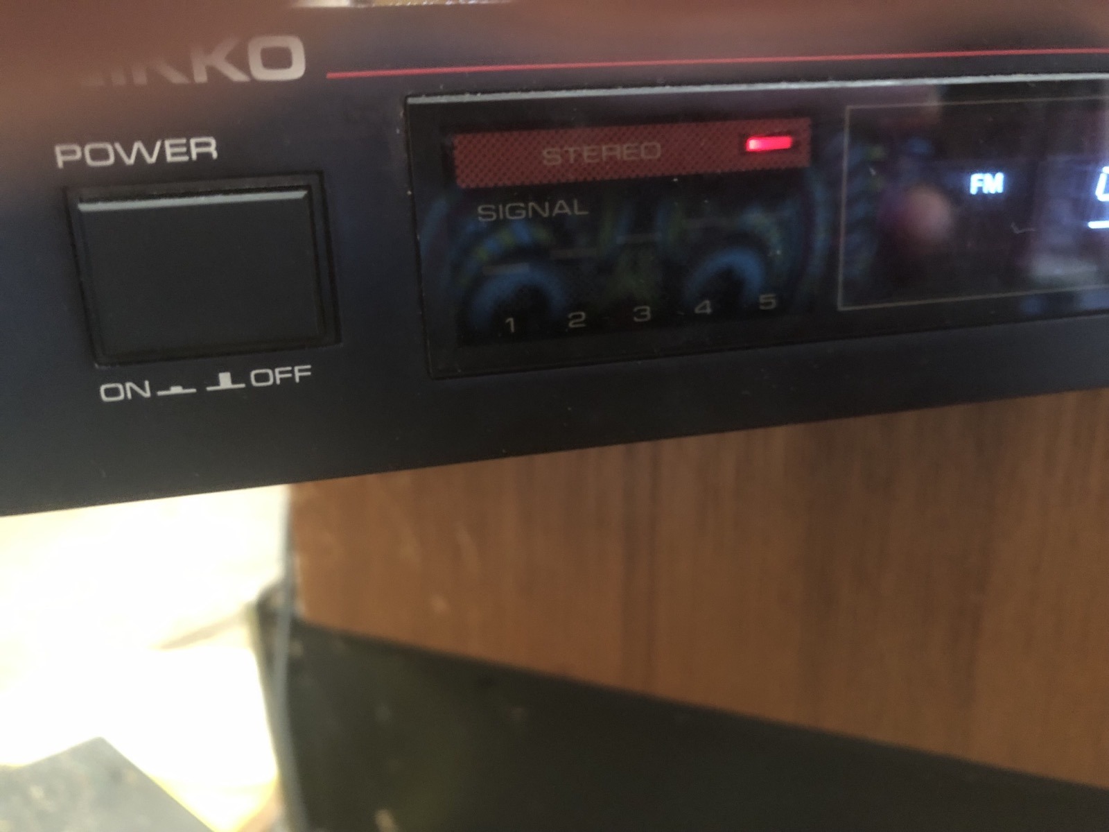

Finally got that Dunikko stereo signal, now playing from LA1235 implemented in Dual tuner and connected to the LA3401 PLL decoder on to Nikko tuner.
The quality of sound is with more details and more mid bass energy, but I cant measure it. and confirm anything precise.
There is indication for stereo signal on the Nikko without any signal strength indication
