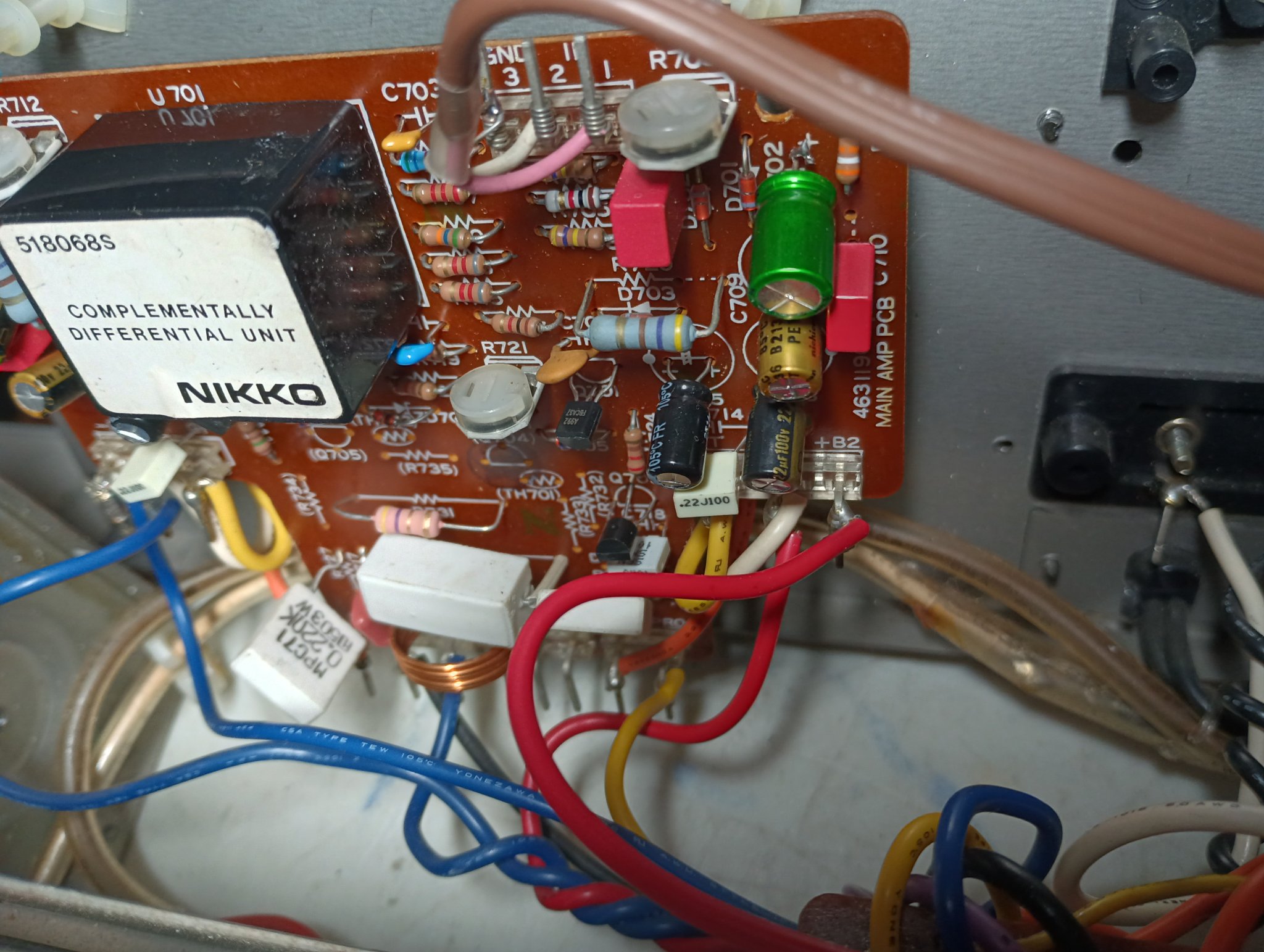

It is the left channel, apologies it was late. Amp is connected to preamp with a regular rca jack patch cable woth the red and white ends. The left channel with static is also the one I had recapped earlier this year. Once i get back up there I will inspect solder pads and confirm correct caps were used and not a wrong size one inadvertently used.
It is a long thread - did you swap U701 module at some point earlier?
You could also post the list of new capacitors you used then - not possible to see on the photo.
It is a long thread my apologies there was a lot going on with this thing. The channel in question the module was removed and transistors replaced in it. The transistors were HFE matched with a component tester I have. I will make a list of the caps I replaced, all of the electrolytics and some of the ceramics. I use Nicihcon caps either KW or FG series caps. I will post the exact values and locations as soon as I can.
I can say Molly and I had this amp playing fine at one point before all the pulsating light issues came about with no static in either channel. Makes me wonder if that frayed wire I found took out a tranny or resistor. I will be up in my work room later today , I have a honey do list that needs to be rectified first, lol

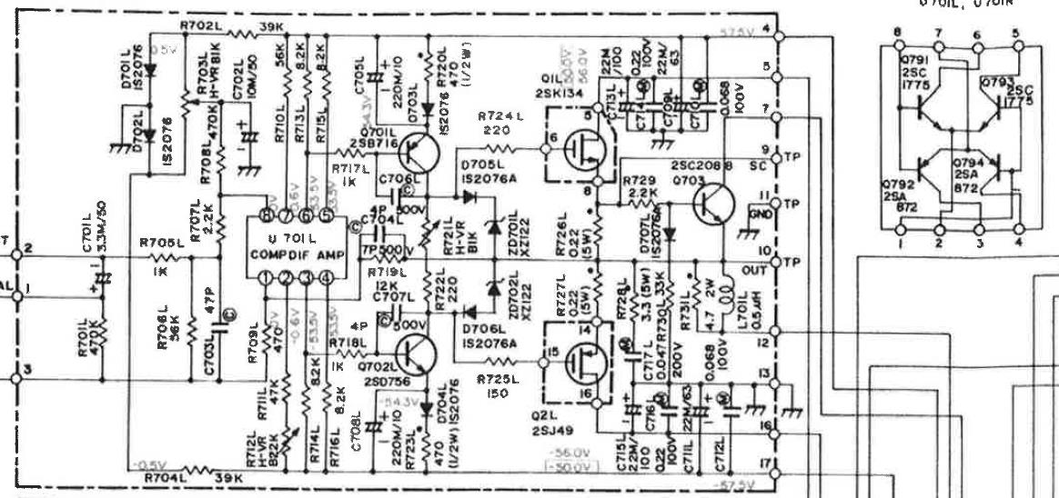

Can be anything, you should start checking voltages again and comparing these to the values in schematic.if that frayed wire I found took out a tranny or resistor.
C705/708 can also be potential suspects if they are still 10V ones.
R704 and 702 are measuring -55vdc and 55 vdc on both sides of the resistor where the schematic shows it should be -.5vdc and .5vdc respectively, is this an issue?
So how much across/between the leads of C705 and C708 (each of them measured separately, not together)?C705 55vdc c708 -51vdc
It will give indication of current through the resistor-diode chain that is in parallel with them.
Fixed. Loose solder joint again.. q701 emitter. Cleaned it up resoldered and now its playing just fine.
