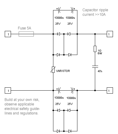

Konnichiwa Kuei Yang Wang
>>>...Ever since I started to use circuits that keep DC out of my Mains Transformers and PSU circuits...<<<
Could you suggest a schematic for a DC blocker that has proven to be effective? I'd like to try building something like that here.
Doumo arigatou gozaimasu for any assistance.
Morse
Morse
Blocking Dc.
Indeed that does make a huge difference.
Some ways I know of to go about it:
- An expensive airgapped xformer
- An electrostatic screen + using CT windings on the secundary side.
- Keeping high current windings on separate xformers.(heaters for instance)
- Using series regs + high capacitance behind them, chokes help too.
-The other way + some of the above:****
****Use at your own risk, I haven't actually tried this...I think it was TL who proposed it first so I welcome his comments.
At first glance it should be fine but beware of safety measures and use it at your own risk.
Cheers, 😉

I found very similar circuit in one of Mark Levinson amps http://www.diyaudio.com/forums/showthread.php?s=&threadid=3924&highlight=circuit+explanation+needed
How does one keep DC out of the power transformer? Unless you use capacitors in some kind of bridge between the winding points and the rectifier, there will be DC flowing through the secondary.
How does the above circuit work? Is it a direct coupled circuit to use AC straight from the wall? Otherwise.. there would be no DC through it at all... from what I could tell first glance.
