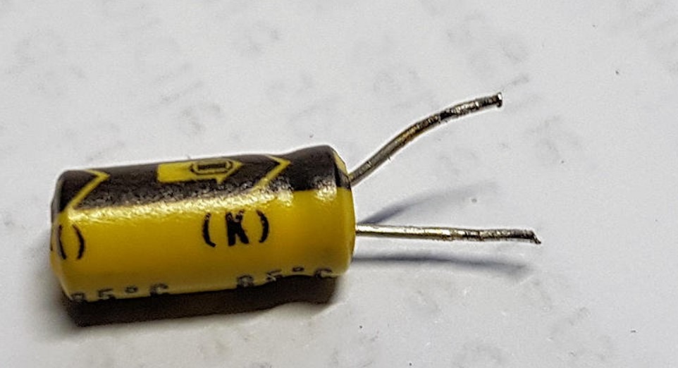

We use to replace the orange LN capacitors by Low Leakage caps, such as Nichicon KL for example.
But sometimes we find YELLOW capacitors, like this Nichicon :
What are the specificities of these yallow caps, and what would be the best replacement ?
Thank you

The "K" stands for "close tolerance " = 10% which is good for an electrolytic , as no other information is shown in your picture ( apart from temperature ) --according to Nichicon,s own coding chart that's it ---unless somebody knows better ?

Yes you are right: "K" means a 10% tolerance, but I would like to know if such a capacitor has another special caracteristics ??
(like the orange ones that are "LN" caps).

JMFahey is right , its not enough just to mention a capacitor briefly you must put all the inscribed details that are marked on it .
LN is just a SERIES by Nichicon -- now discontinued for new work.
Its just a bit smaller than the LS SERIES --nothing particularly special about it.
Dont go by the colour --go by the manufacturers spec .

That sheen looks 70s/80s.. almost waxy
