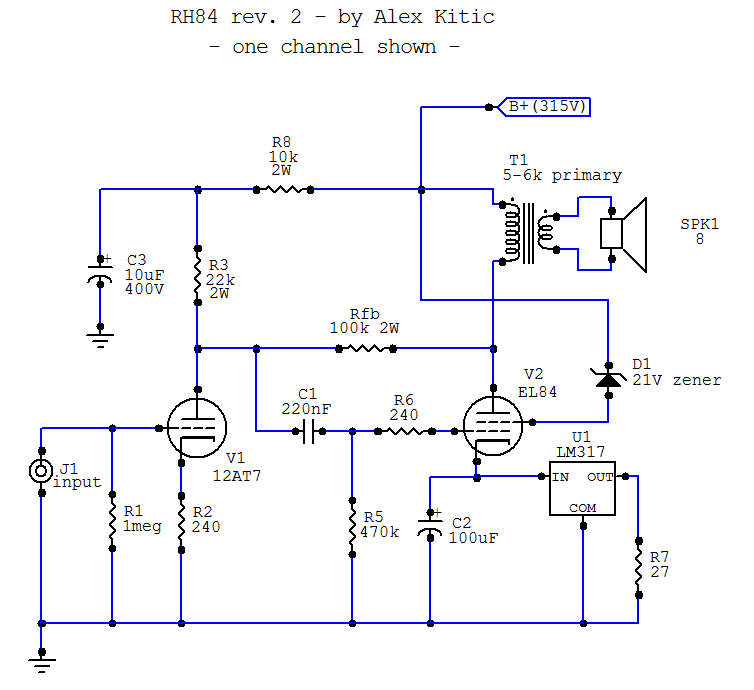

I am about to make an order on Mouser UK for an RH84v2 Project.
Can you say how the Rubycon LLE caps compare to the others mentioned in the thread?

RH84 V2 (C1) 100UF Coupling Capacitor
I have bought some Elna Silmic II for the 100UF coupling caps on the EL84.
I want to buy and try Nichicon FZ and FG as well.
FZ: https://www.mouser.co.uk/datasheet/2/293/e_ukz-3082249.pdf. These are available up to 100v
FG: https://www.mouser.co.uk/datasheet/2/293/e_ufg-3082295.pdf These are available up to 63v
Rubycon UKZ2A101MHM1TN https://www.mouser.co.uk/datasheet/2/977/e_LLE-1600605.pdf
I am looking at using them for the coupling cap on the EL84. Is it worth using 63v, 80v or 100v ratings or is that overkill for this position?
RH84v2 (C3) 10UF 400v Capacitor
I am also thinking of using the Nichicon LLE for the (C3) 10uf 450v capacitor on the RH84 V2, or I could use a 450v Kemet PEG124 Capacitor.
https://www.mouser.co.uk/datasheet/2/447/KEM_A4011_PEG124-3316431.pdf
I would really appreciate a steer on this as I am keen to order this week.

Rubycon LLE caps DON'T have low ESR, but they do have very long life at 105C.Nichicon doesn't make FZ caps, Rubycon doesn't make UKZ caps.
Capacitors panasonic fm are good for decoupling
power supply and other low esr
low volt can use oscon panasonic sepg 16volt
up to 470 uf
you use a combi in the signal path panasonic sepg and elna Elna Silmic
up to 470 uf
