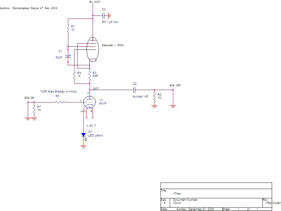

Hooked up a CCS on the anode of one of my simple common cathode linestages.
Using a SV83 as the CCS. OK maybe inefficient but not worried about that. Getting a nice stable 190V from the CCS.
Very nice indeed.
Bass amongst other things significantly improved.
Never had much success using 6N1P's but now it really shines with the CCS on the plate.
Also replaced the cathode resistor/cap bypass with some yellow leds. Got a perfect 1.85V on both cathodes.

QQ
mu stage
Looking at this article above I see he takes the output of the gain stage between the cathode of the CCS penthode and RK2 (V2's cathode resistor) at the point where the cap is.
I am taking it off from the point below the cathode resistor.
What difference would this make?
So far I'm getting good results. (took the CCS design from Pete Millets low mu amp).
tweeked design:
my best sounding amp to date.😀
Correction. R5 is 910 ohms Holco.
