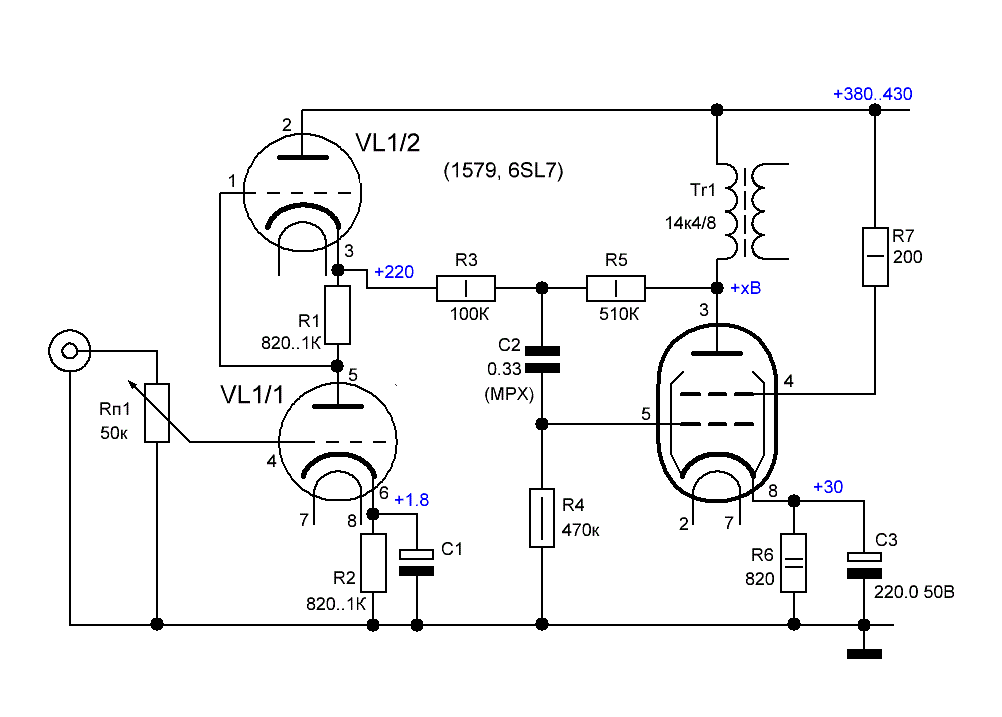

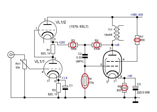

Resistors dissipate power
For R3 and R5 - 1W
For R4 - 1/2W
For R6 - 2W
Sometimes you can see it here and there.
"Вт" means "W"
(Russian schematic flavor)
