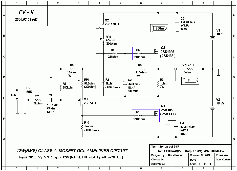

this 10W FET amp really sounds good(sweetly & Warmly) when I using K1056 as ouput devices,here is upgrated version below:

Re: Re: Re: hum...
I think the amp would benefit from a servo loop.

hello Wavebourn:
Please show me your idea with a picture!
this problem is still my puzzle,input stage isn't got full DC feedback from output point,this can make the circuit works not steady...
any commend, please reply,thanks!
