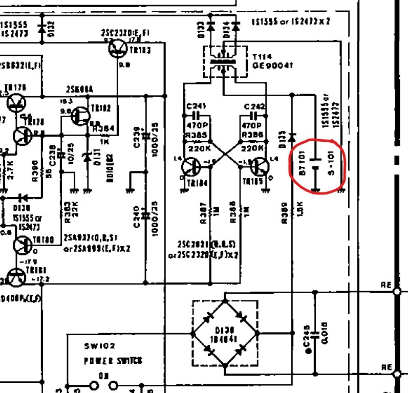

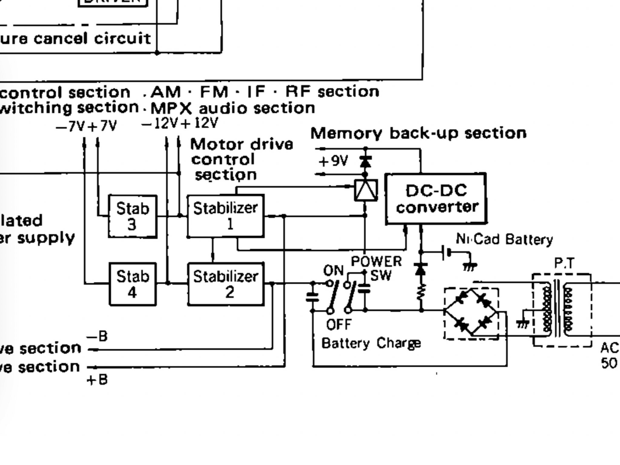

It would be interesting to know what voltage is produced. It is just a way to transform the 1.2V to a higher voltage. If that is around 4 to 5V then a Supercap could replace the circuit alltogether with some changes like the series resistor.
The memory could retain its settings down to quite a low voltage although in normal operation the rail looks to be 9 volt as it is tied via that diode (top left in image) to a rail.
Looks like the charging circuit is just half wave of the transformer which in turn looks to be about 20 volt peak give or take. So about 12ma peak charging current. That 1.5k could be a typical failure item if it is just a small 0.25 or 0.5 watt. Worth checking.
I had suspected that. RAM to work on 1.1V was unavailable until quite recently. PC CMOS/BIOS batteries were 3-cell Ni-Cad. While an always-on oscillator seems extravagant, watches with single cell had become common.
Going back to the 80's it was common to see single 1.2v cells in some Philips TV's. They were a major failure item. I have a (vintage) Philips dating back to the 80's that also had one of these and about 15 years ago I replaced it with a 3v lithium coin cell and series diode along with 'snipping' the charging resistor out of circuit. It is still going strong :}

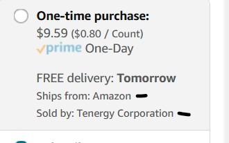

the NiCD batteries from Amazon arrived today, they look fresh, mint, and legit.
ran 4 of them through testing by my Opus charger and they all did acceptably well
