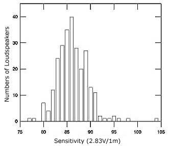

Let’s start with the sensitivity or could it be efficiency then bandwidth, what’s normal and what’s the top end units have? Impedance, why 4 ohm or 8 ohm, where is the performance and the reasons for the difference? Where might Ifind a thread explaining all this stuff? Thanks
An average sensitivity is 88dB/2.83V@1m
Values can range from 80dB/2.83V@1m (flat panel speakers) to 95dB/2.83V@1m (professional monitors).
The attached graph shows the range of sensitivities of a selection of modern loudspeakers.
I found this informtion here: HiFi Loudspeaker Design
The lower the impedance, the more easily electricity (the signal) flows through the speaker. Low impedance is particularly helpful in car audio systems as the driving voltage available from a car amplifier (powered by a 12V battery) is lower than that available from a home amplifier (powered by the 120/240V mains supply). Hence, 4 ohm is traditionally the impedance of car speakers and 8 ohm is traditionally the impedance of home speakers - although nowadays this distinction is becoming blurred.
