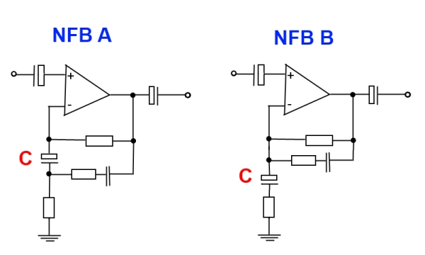

Anybody knows what is the different in those two types of NFB?
What are the advantages of putting NFB ground capacitor in the position A?
I saw that NFB in some cassette decks playback amplifier and wonder why they put capacitor at that position.

NFB B is the usual circuit (with a small cap over the feedback resistor), a separate RC series branch controls the hf-feedback better. NFB A is to bypass the large groundcap (with lesser hf bandwidth) so the hf feedback works even better.
